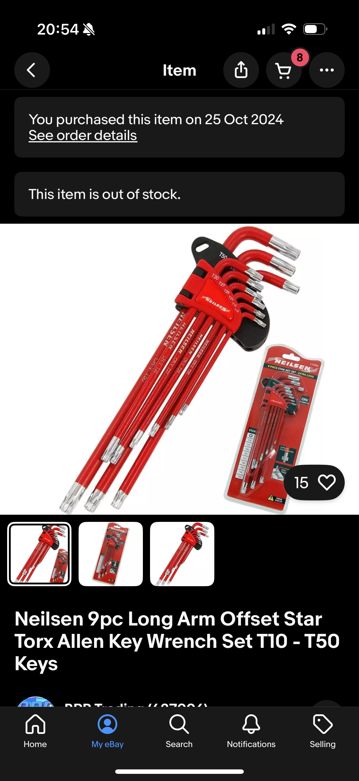

Today, I had ago at removing the tyre storage box to swap the locking nut off the spare wheel. Noticed that the 3 torx nuts fastening the storage box to the wheel was stiff as hell. Good job, I purchased a set of long arm torx alley key set to put in my car tool box and proved very useful. I put some acf50 on all the bolts threads to stop them seizing in the future.

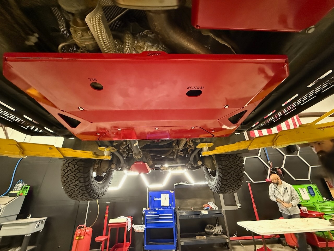

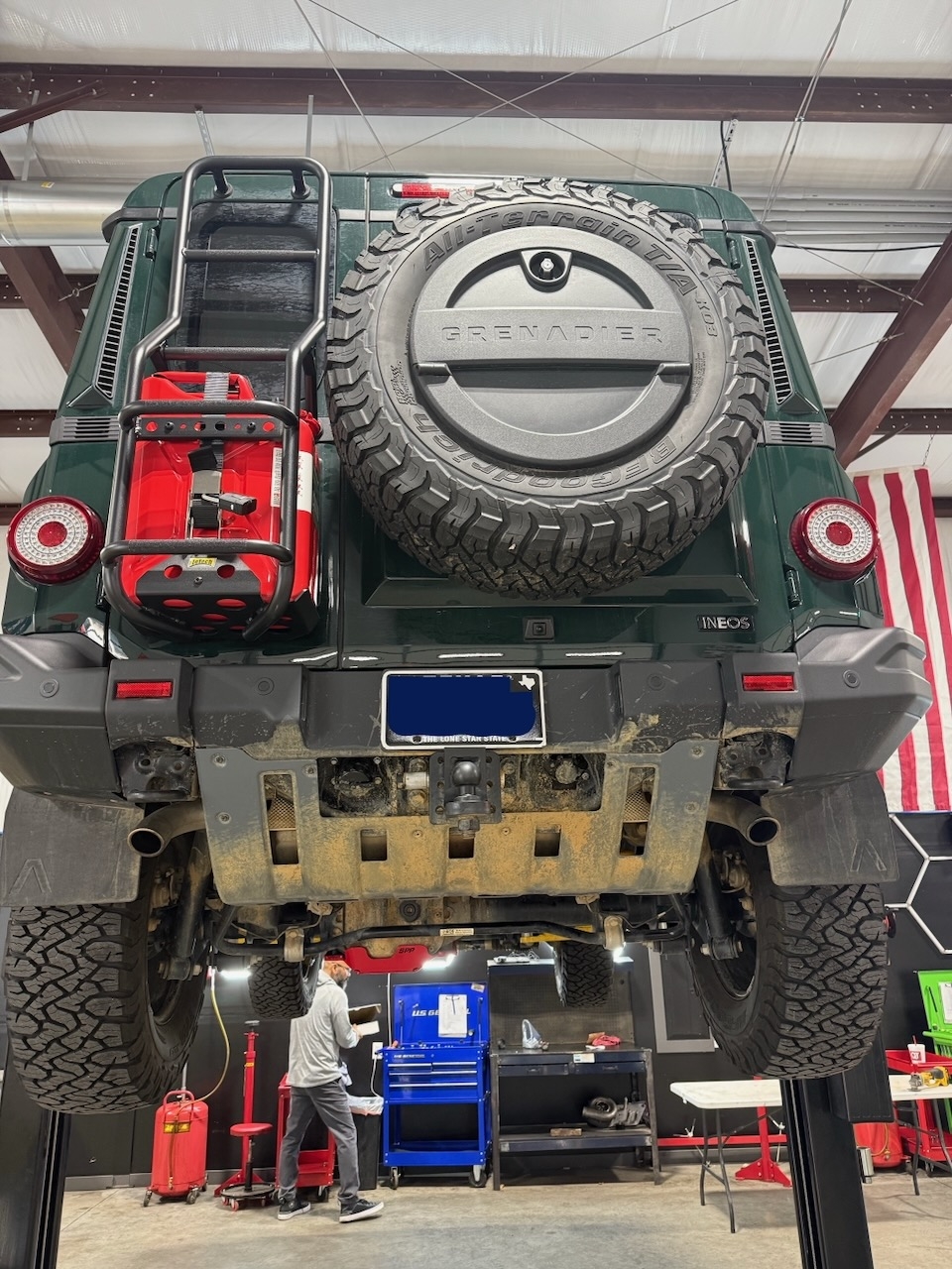

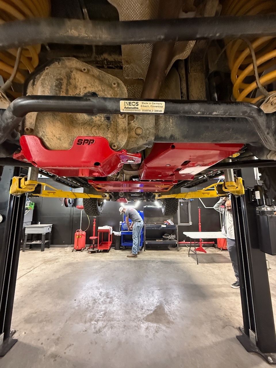

Update to SPP skid plate install. Finished and got the fuel tank plate installed. You have to cutoff one of the factory skid plate brackets to both theirs to the factory one. Didn't appear to be too structural, it was thin sheet metal. What I can say is while the kit is nice, there are some gotchas like that and then the transmission plate has two rivet nuts and you really need the tool to install properally, tried it without the first time and wasn't successful. I also switched from the M10 rivet nut SPP provided to a M12 rivet nut and bolt as it fit the hole better. No instructions provided and shipping from Germany was expensive. If I did it again I'd go Agile or Rival.

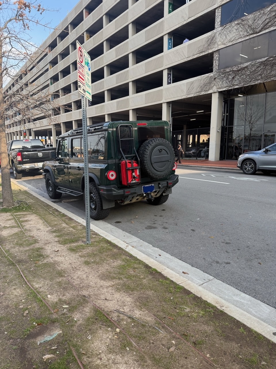

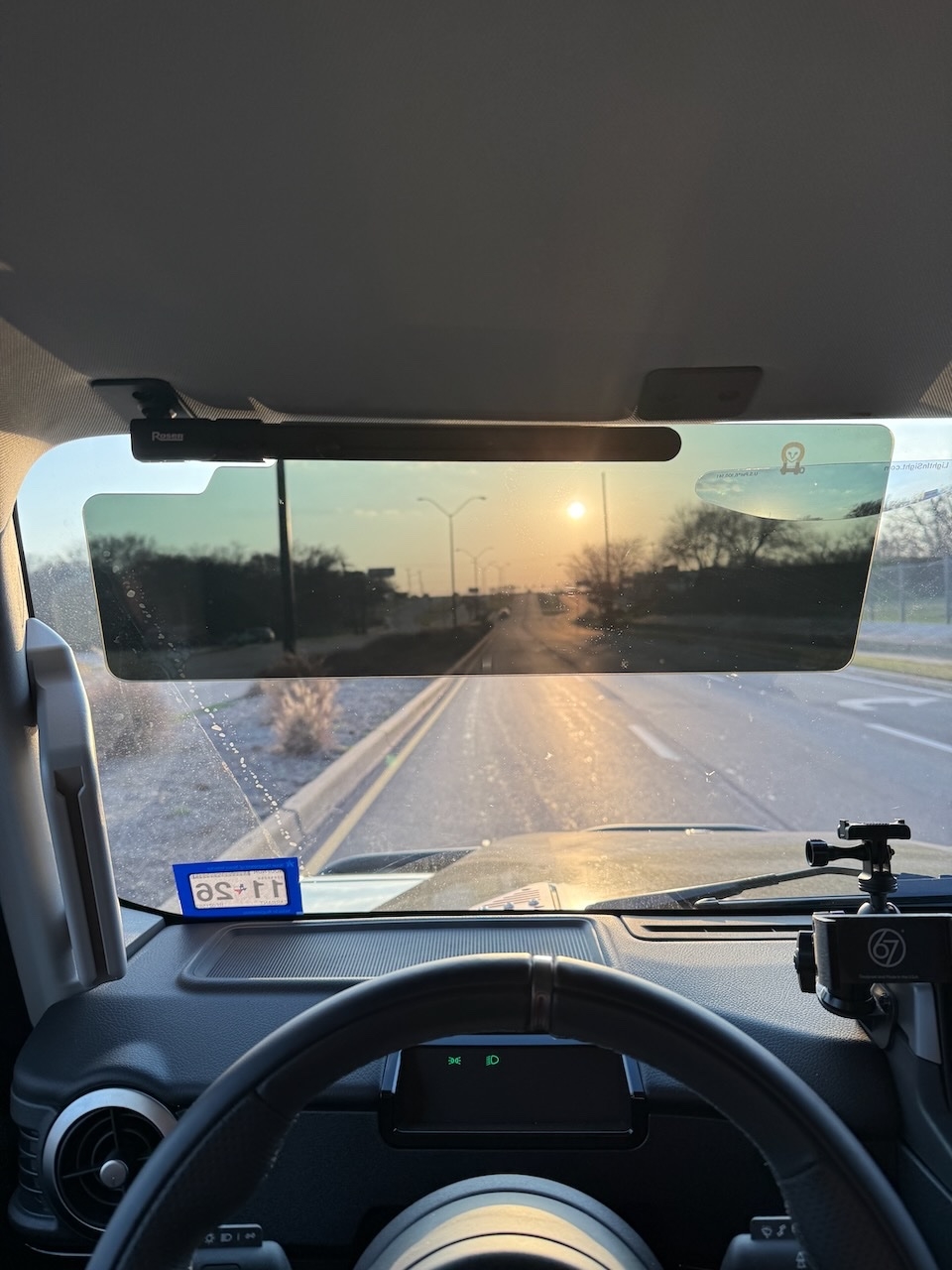

Added the Rosen visor upgrade from Owl, really nice since I sit tall and could never use the visors anyway. Also added the LeTech ladder and Jerry can. Picked up from Warner in Utah. Good to deal with.
