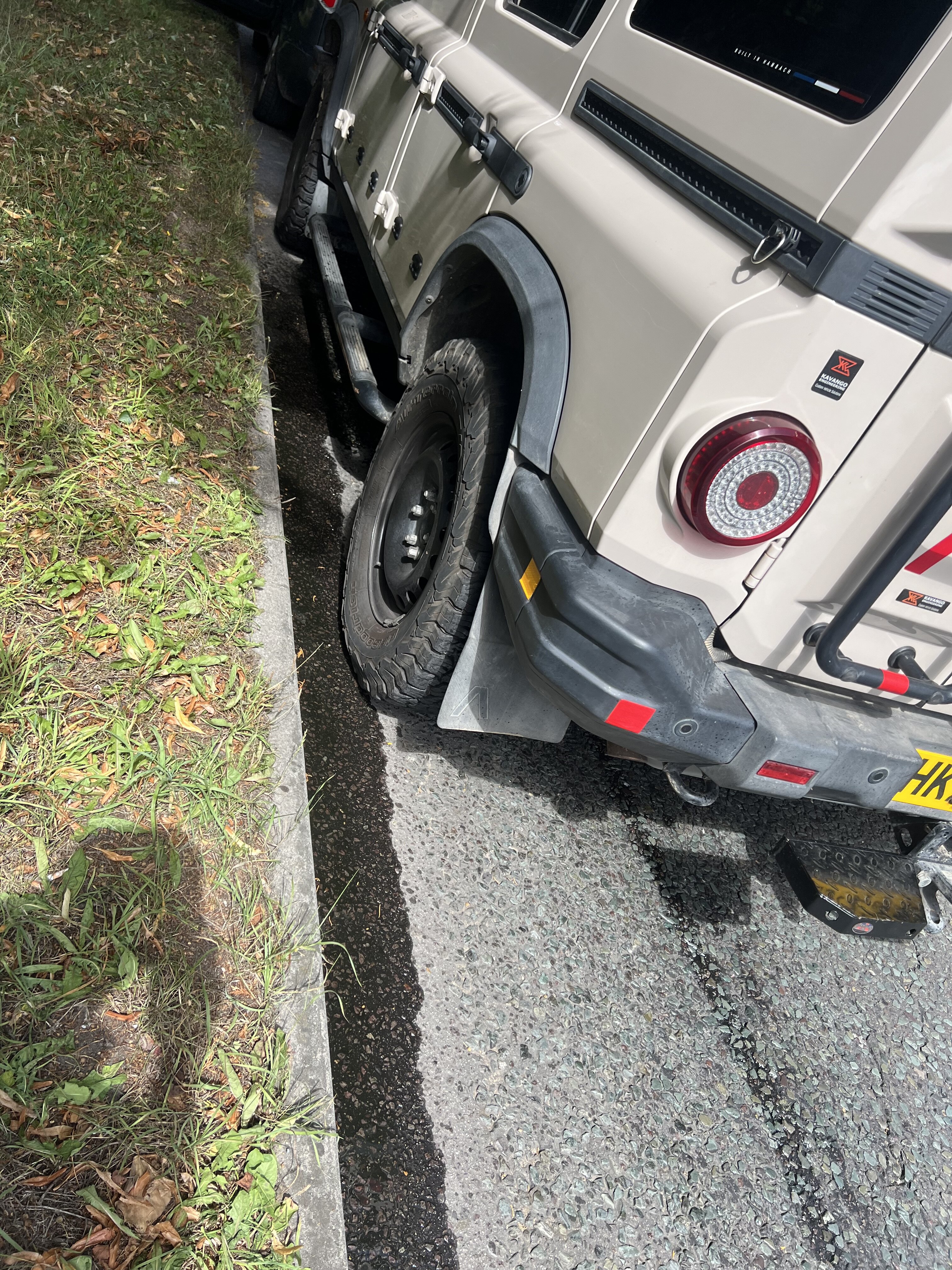

Well the AA technician has been and just left and it turns out the Cardan joint on the front prop shaft has snapped in half and the prop shaft has smashed into the gearbox. Hence the loud bang. 😳🤬🤬View attachment 7866966
ok that is a step forward for sure. nice to know what it was for you.
sorry it seems like im polishing a turd.
good luck pal in having Liberty back asap
On a positive note because the front prop shaft is in two pieces and the gearbox probably in many pieces the vehicle does roll with the handbrake off. 😎

My afternoon has been ruined. Driving on an A road just outside Poole about 35mph in a 40mph limit and an almighty bang. Stopped the Grenadier got out and Transmission oil everywhere and no drive. Now waiting for the AA 🤬🤬🤬🤬
Oh no- I hope nothing broke or cracked…..although this „bang“ sounds like that it is not just a drain….good luck
Hm- wasn‘t there the same case just a fee weeks ago with somebody on vacation? With the same topic? Will try to find that note…..
There was one in February:
That was exactly what I had in mind…… thanks Jean
The thing from that thread that jumped off the page was the possibility of a seized transfer box. That would create a big bang as that snaps the prop shaft.
