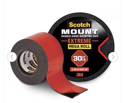

This will probably sound rather insignificant but it may affect other people who live in similar climates to me.
It regularly falls off my back window. The provided adhesive just isn’t adequate in the desert climate (Phoenix, Arizona). And Wolfbox isn’t unique in this problem - adhesives for accessories constantly fail here due to temps up to 117 degrees at times. And even though windows are tinted - it still happens!
As the vendor, I wish you could identify an adhesive that would work in this kind of climate. I may try Velcro but don’t know if that’ll be any better. It’s a real pain when it falls off, especially on trips when you’re on the highway and the cargo area is packed to the roof!
I used this. First I cleaned the area with alcohol prep wipe on both surfaces and after they were dry, I cut just enough to fit the rear camera. The camera is solid. Rock solid so far.
