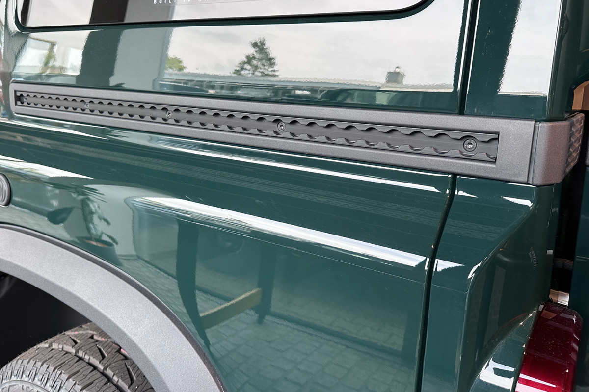

Just go to e.g. Airline Rails Slim, get some M6x20, cut to length with hand metal saw, drill, countersink boreholes, mount.
1 1/2 hours for both sides if you work slowly (like me :) )
Not even 40 EUR for both sides (but the rail doesn't come black, black anodized are very hard to find and are more expensive).
If you are able to get some with 25.4mm pitch, it's even easier.

link didn't work for me. I have found the rail here in the US, just not able to find the narrow stuff that isn't already drilled. not a fan of all the holes not lining up. I suppose I could fill the ones that don't with some type of material, if it came down to it.
Found black anodized airline rail with 25.4 pitch. It's a different profile than OEM and the bolt holes at ~7" o.c. will not align. It is the proper height at ~1.75"
I used the ones with EDIT: 25mm width, rectangular cross section that fits into the slot of the original plastics trim.

At least they seem to have inch pitch; well possible that these are the "genuine" INEOS rails.
Maybe it would be fair to mention that this offer includes the complete set, including the rails and plastics parts for the doors plus the screws & nuts.
