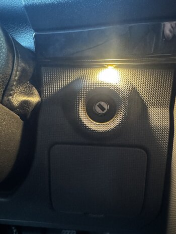

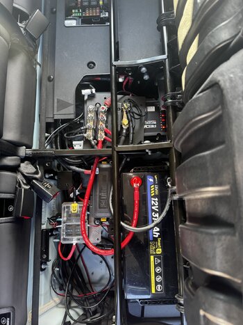

  • Genesis OMEGA Dual Battery System - First a little history: Genesis has a really slick dual battery system for the Jeep. It was on my wish list for when I outgrew my Bluetti power station. As I was just about to pull the trigger on a Victron setup, Genesis released a kit for the Grenadier. It looked super clean and used all factory mounting points, so I chose to go this route. Also, I know their setup will be cleaner than anything I can workup in my garage so it was worth the small expense above the equipment costs. Additionally, I made the choice to go with an off-brand LiFePO battery and inverter. I am curious to see what the longevity and performance is and willing to risk the small investment. Now for the install experience...
    I'm an idiot and didn't pay close attention to their install video. Their prototype vehicle didn't have any options that required the additional LittleFuse block on the passenger side. They use those mounting points for the plate that holds the busbar and Redarc Smart Battery Monitor. I contacted Genesis and Shane responded immediately. I sent him some pictures of the area and he said he will start working on some options. He even came back with that he will likely trade his Grenadier for one that has the extra auxiliary switch pack. Without me prompting, he stated that he would ship me out a fix once they figure it out. Based on the quality of their other products, and his immediate response, I'm not upset. I lost a little time, but I also got to know the electrical setup a little better so some good came out of it. So, I had to jerry-rig up a solution to put the car back into daily driver use.
    As of now, I didn't install the inverter and solar charging isn't working. I may not have crimped the connectors correctly when running the Lensun cable. I haven't investigated it yet. Also note that the Wattcycle battery barely fits the space. The forward piece of plastic trim doesn't fit as a result. So, I would not recommend it based on the size, but I'm leaving it for now. I will be doing a backseat delete in the near future so I will likely need to rearrange some stuff anyways. Plus, I am curious to see what Genesis comes up with.
    When viewing the picture, yes it is messy, remember it is all temporary. If you put the seat down, it looks great!

"Their prototype vehicle didn't have any options that required the additional LittleFuse block on the passenger side. They use those mounting points for the plate that holds the busbar and Redarc Smart Battery Monitor. "
I was going to order one of these too as it looked very clean, but noticed in the pictures that he didn't have the additional fuse block, so went another route.
From a quick glance at the GP-Factor kit, here is what I see is different. Note for ease of typing, I will refer to GP-Factor as GPF and the Genesis Omega as GO. All comments on the GO kit refer to "now" and not the potential location fix for the busbar and Redarc Smart Monitor.
  • GPF includes 50A charger compared to GO's 25A
  • GPF does not include the Redarc Smart Monitor
  • GPF's mounting plate looks easier to install.
  • GPF does not include a busbar - cheaply remedied with a quick visit to Amazon, plus you can mount it where it makes sense. The GO kit uses the mounting points occupied by the second LittleFuse box, so I have the busbar & SM resting on-top of the OMEGA lid.
  • GPF kit is to be used with the removal of the factory AUX battery and CTEK unit. It also reuses slots on the LittleFuse box. The GO system is better suited models without the factory installed AUX battery.
  • I believe both kits have "clean" wiring setups from the BCDC Charger, based on their use case.
  • Neither system includes the ability to mount a fuse box, like BlueSea. You will either have to have your own mounting solution or use cables with inline fuses for all of your accessories.
Side note: Agile Offroad has a Universal Mounting Plate that would be large enough to mount the Charger and the Smart Monitor. Possibly the busbar also?
If I had the Factory Aux Battery, going with GP-Factor's kit seems like the winner. As it stands today, if you don't have that 2nd LittleFuse box, the Genesis Omega would be a clean setup. If you are in-between, I would lean towards getting the Agile Offroad plate and figure out how I would wire it all together.
Hope that helps?
Hope that helps?
Great summary and I agree that GP Factor seems best for vehicles with the factory aux battery and Genesis seems best for vehicles with only the starter battery.
