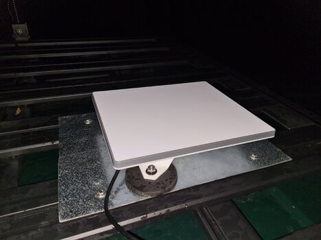

I repositioned the Starlink mini so I could use EXT 2 and unfortunately I had the same result as previously, i.e. it worked for a couple of minutes then dropped out. Once it drops out it won't come back on. I guess I need to find out why I'm not getting a constant minimum of 12v at the outlet.
I had been having battery problems with the car but had a new battery installed before using the starlink.
By the way, if you buy one of these owl magnetic mounts don't expect to be able to easily remove it from your roof. The magnets are incredibly strong. I have ended up mounting it on a steel plate that I have bolted to the roof rack so that at least I can take it off the roof without having to get Eddie Hall involved.

Hi All
