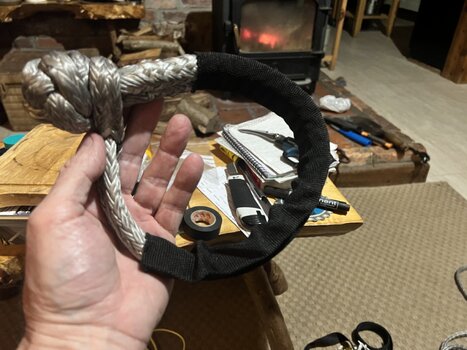

So in my boredome of some enforced time out and also not having the Grenadier to play with at the moment, I decided to go back to my occasional hobby of playing with ropes. I’ve made a few soft shackles in the past and realise that the button knot although touted as the strongest soft shackle knot, is not the easiest to tie. So in my research I came across a much simpler and just as strong knot upto 230% stronger than a single strand of the same dyneema rope that it is made with. It’s so easy to make but not the prettiest of knots as not symmetrical. It’s impossible for this knot to collapse as the ends are buried in the shackle itself as with the button knot. It’s called the improved soft shackle with Brummell splice and buried ends. A bit of a mouthful, so I’ll just called it the improved soft shackle.
Happy splicing. Illl send links to rope and splicing tools in another post .

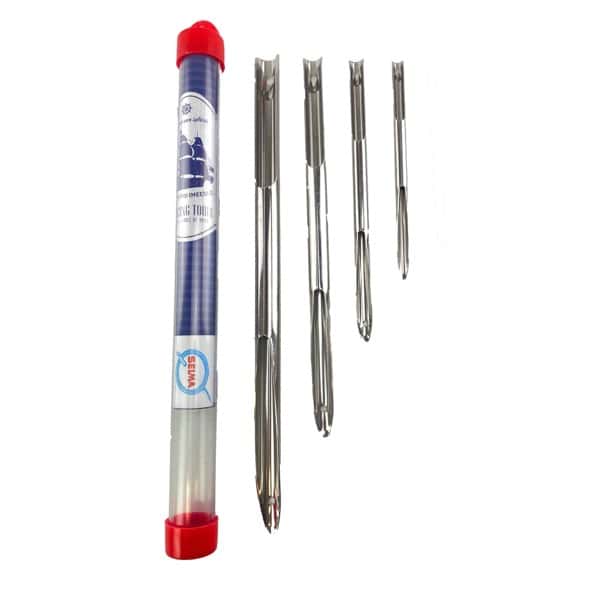

I have a set of Felma fids and a D-splicer. All readily available from rope suppliers, chandler's, Amazon etc
Believe it or not this soft shackle with dyneema using the technique above used 1.4m of 4mm dyneema rope. To make a soft shackle with 10mm or 12mm dyneema you would need 2.5m to 3m of dyneema for a decent sized shackle. Too small and they are fiddly to use especially if using a large recovery ring.

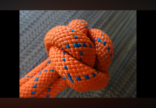

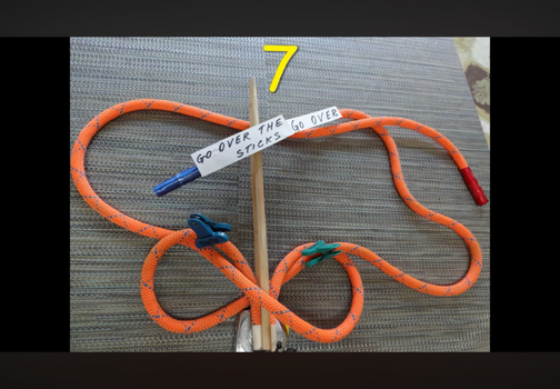

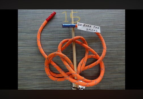

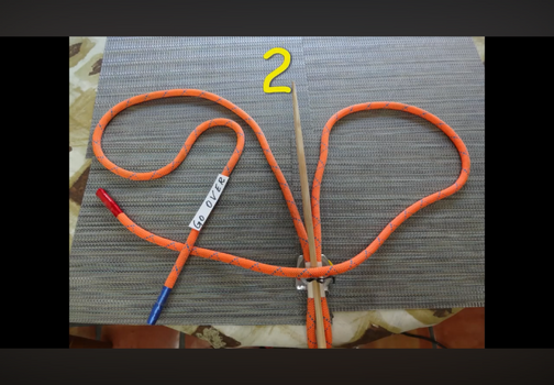

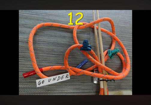

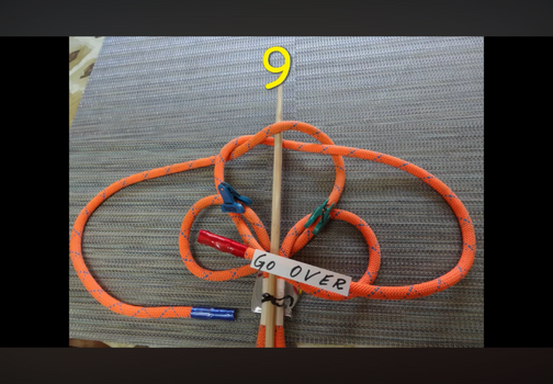

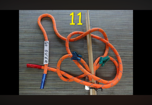

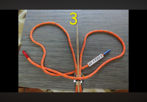

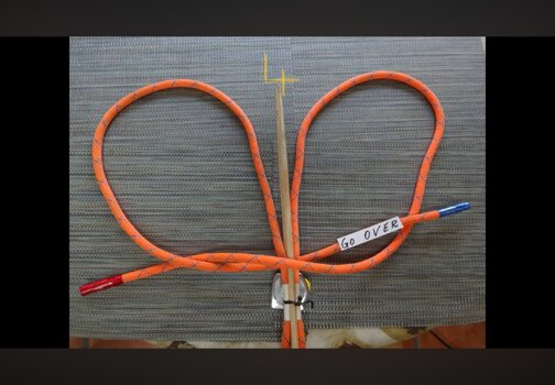

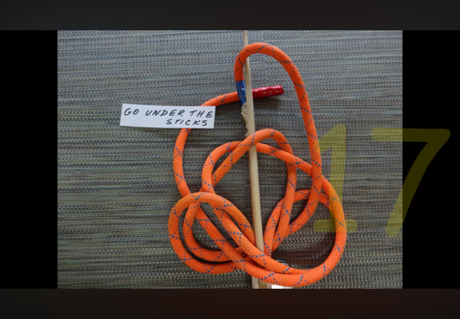

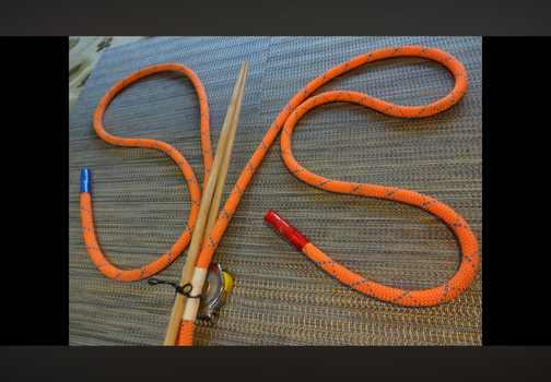

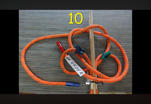

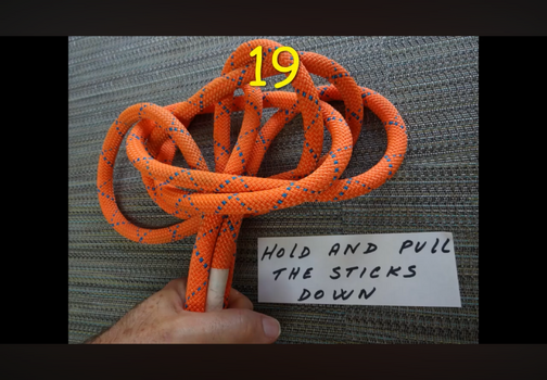

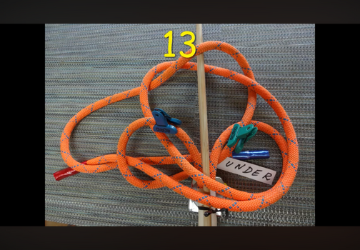

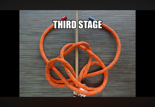

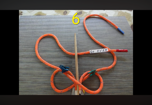

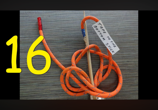

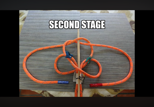

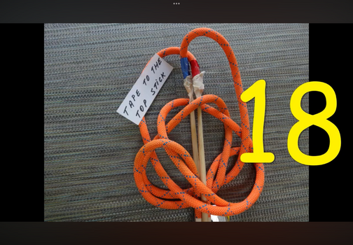

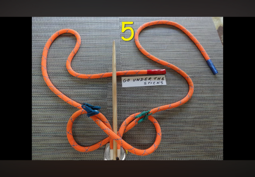

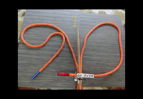

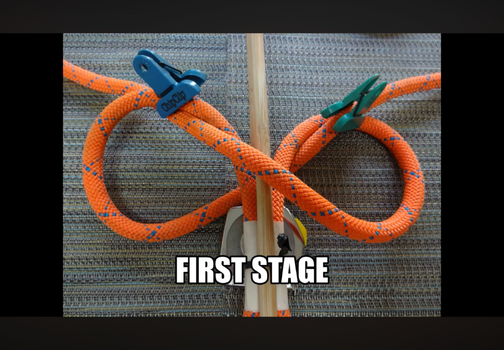

The best tutorial I’ve ever come across on making the button knot. I’ve screen shot each stage the only thing to do after Is to taper then bury the tails. Some rope protection sleeve to help protect it and you’ve got a great soft shackle.
I might have to post a few photos per message to get them all to go but it’s super easy to master once you get the hang of it.
IMG_2378.pngIMG_2379.jpegIMG_2380.pngIMG_2381.pngIMG_2383.jpegIMG_2384.pngIMG_2386.pngIMG_2387.pngIMG_2388.png
