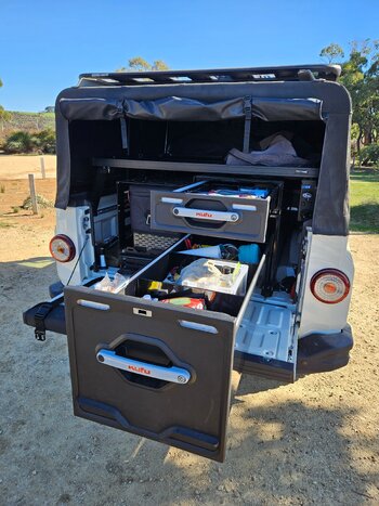

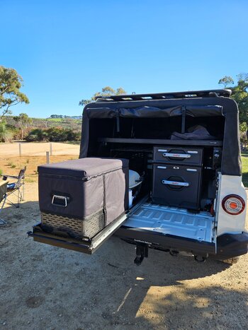

Hi all, thought I would finally get around to posting about our QM build. Hope there might be some useful info in here for anyone else thinking about similar mods.
Base vehicle is a 2024 QM - base version with high load aux switch panel and diff locks.
Plan is to build a tourer capable of 4-5 days self-sufficient travel for a family of 4, without having to tow a camper trailer or caravan. Must have robust improvements to deal with the usual issues of the Australian bush - corrugations, kangaroos, more corrugations. So the list below is what we think needs to be done to the QM to be long-weekend travel ready at any moment:
  • The first item for us was to increase the load capacity of the QM. We are going to use up the sub 800kg load capacity in a hurry between additional fuel, water, fridge and power station, recovery gear, and the general stuff that a family drags around when they travel. So a GVM upgrade is needed.
  • We want to retain the tub and work out a way to maximise (and organise) storage space. Including significant water storage - 150 litres min.
  • Power to the tub for the fridge, any pumps, lighting, etc. Allowance to use the vehicle batteries for certain aux. use and also for solar input to the vehicle batteries. Fridge to run off a power station, probably 12V only and not an inverter system - we dont need to run a coffee machine, or any of that rubbish (though inverter cooktops are pretty awesome).
  • Install a long range fuel tank, ideally to have over 1000km range. Just the extra fuel and water are why we will need the GVM upgrade.

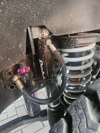

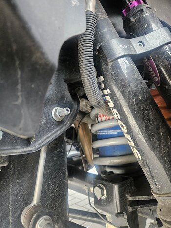

To follow on from the first post, the list below is the work completed so far:
  • 4,200 kg GVM upgrade, incl. +35mm lift - DMW fitted by GrenX
  • Bilstein steering damper - based on comments from this forum
  • Offroad Animal Toro Bar
  • Brown Davis 106L aux tank
  • Warn Evo 12S
  • GrenX Lightforce Venom driving light grille kit
  • Black Sheep rocksliders
  • GrenX 4.5” Stainless Steel Snorkel System with Sealed Airbox - supremely unnecessary but so cool
  • CTEK D250SE - based again on comments from this forum
  • REDARC Tow-Pro Elite V3
  • The above parts were fitted by GrenX, who also added some additional wiring to the tub for solar input, 12V out, and alternator
  • Also changed the tyres to 255/85/R17 Mickey T Baja Boss ATs - various reasons for going narrow and doing this along with the GVM means the ute is now stickered for this sized tyre.
The GVM upgrade involved +35mm springs, Dobinson remote reservoir shocks, brake line extensions, etc. and airbags in the rear.
Since this work was all done pre-registration and before I took delivery, I can't comment on before and after feel on the road, but it's a comfortable drive. Obviously seems happier with weight in the back, but still well behaved when the tray is empty.
