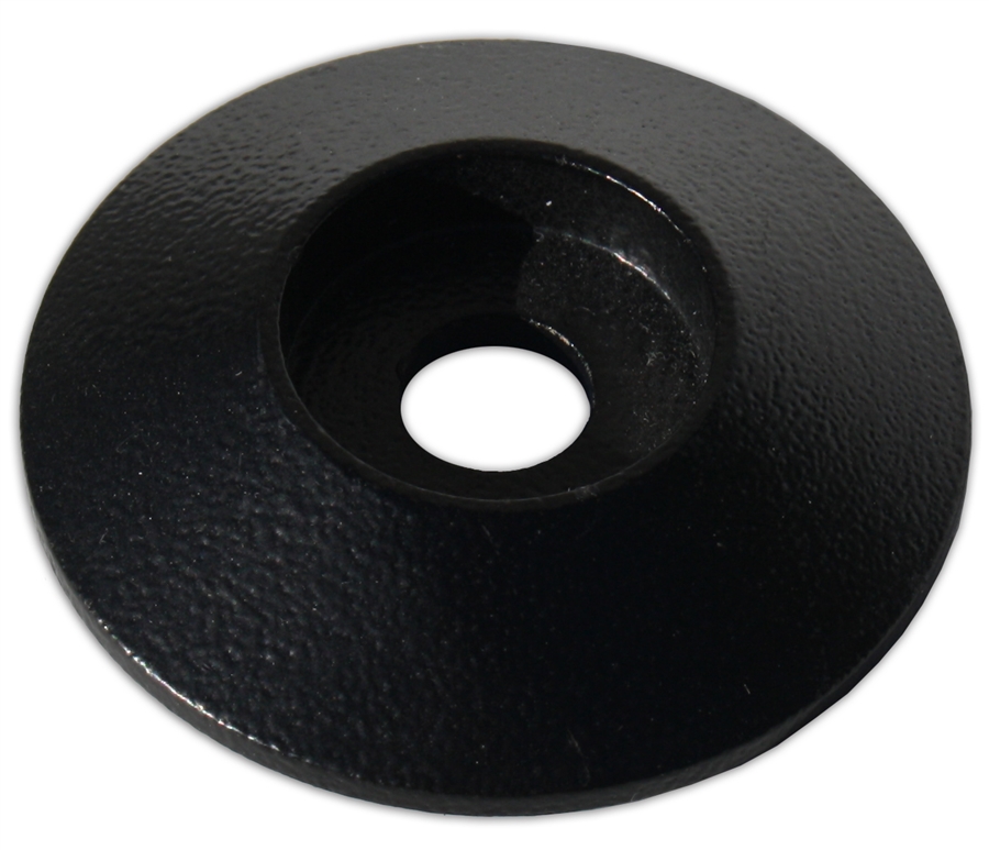

Is that a kydex plate on top of the sliders? It looks fastened down by bolts. I live in New England and I would be concerned about moister and road salt sitting in between the plate and the sliders. If that occurs, it wouldn't take long for rust to show up. Any thoughts on this?
Those bolts look vulnerable. Would have been nice to protect them.
I ordered some tapered bolt head protectors that I'm going to try with the Agile Offroad skid plates. Doesn't look like there's a lot of thread left there, but could be worth a shot.
