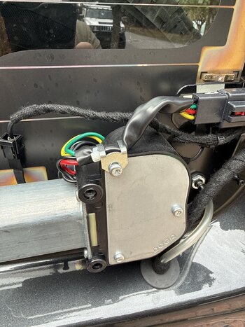

I’m trying to install a rearview cam. I’ve got the wiring ran to the back and need a constant power source for the backup cam.
the wire from the cam isn’t long enough to reach the brake light wires, but it will reach the rear wiper motor wires.
there are 4, and i’m assuming the Red wire is 12V power that i need. My question is, will that be a constant when the key is in the ignition and on or will it only run power when the switch is on for the motor?
Haven’t gotten my access to the technical manual from ineos yet. anyone have the answer?
thanks in advance.

@ibucki74 There are no wiring diagrams included in the owner's view of the tech manuals. You're going to need to test for power with a test light, voltmeter or multimeter. Since you're doing the installation yourself I'll assume you're ok to do that.
In a pinch there is some electrical schematics in the forum resources section here but they're not friendly to use and may not be the same in production vehicles.
Do not use the wiper motor wires. The power to the motor is not constant and is controlled by pulses.
Run your own wire from the reverse light. It is the only correct and safe way to get a switched power signal that activates only when you are in reverse. Splicing a short extension to your camera wire is the proper fix.
