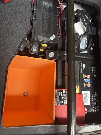

Here is a design I made to fill in the area under the rear seat for a RHD MY24 Trailmaster. Prevents small things from hiding and rolling around the open area and tidies up the area a bit. It's a tight fit and finishes just under the plastic shroud. You can see the scuffs I made installing it on the black shroud.

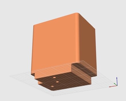

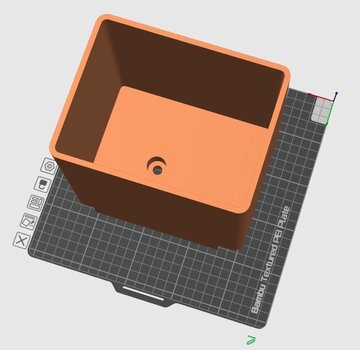

There are a number of holes / cutouts to fiddle over the lumps and studs in the floor and a hole to bolt it down. I used fusion360 to design and then did a few mods in Bambu studio to strengthen a couple of areas. I printed with a 0.8mm nozzle (it's a deep box) with 15% infill except for areas around the bolt hole and the front shelf where I modified the print to 100% infill in those areas. Might be overkill.
Happy to post the files somewhere on request. Can't seem to upload them here.
There are a number of holes / cutouts to fiddle over the lumps and studs in the floor and a hole to bolt it down. I think it's a M8 nut. I used fusion360 to design and then did a few mods in Bambu studio to strengthen a couple of areas. I printed with a 0.8mm nozzle (it's a deep box) with 15% infill except for areas around the bolt hole and the front shelf where I modified the print to 100% infill in those areas. Might be overkill.

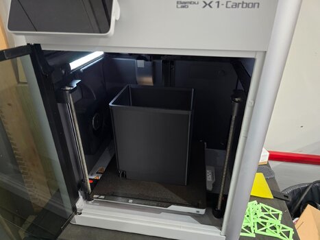

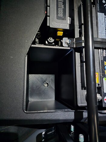

Printed this last night and fitted into the Grenadier this morning, many thanks friend! Printed in ABS, had to unscrew the rear cover to get it in there, its tight! Took about 9-10 hours to print. Couple notes:
a) Positive terminal cover will not go back on without modification, but I just placed it over top, no big deal.
b) Bolt takes an M8 nut.
Great print, thanks again!
That's great! Wasn't sure it would fit US vehicles. Agree - it is tight...was keen to maximise the space.

I did print mine in PLA. It seems very strong as I had to put a lot of effort in to squeeze it down into the space. Bright orange so I could better see any items in there...nowhere for them to hide.
