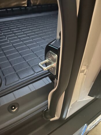

I always had to slam the smaller rear door so that the sensor would pickup and I would be able to lock the Grenadier. I troubleshooted it today and I only had to bring the metal hinge on the bigger rear door out few millimeters. It is the silver metal looking hinge on the rear door here. The door sensor pickup closed now when using normal closing force.
I have the same problem. How to bring the metal hinge our? add a washer?
No washer is needed. Just loosen the two screws on the hinge in the picture and push the hinge backward toward the door rubber, then tightened the screws back. That way the smaller door lock catches this hinge on the large door sooner.

I’ve adjusted my rear door latch today as mines gradually coming loose and starting to rattle over bumps. All you need to do is adjust the rear centre door latch which locks the small door to the big. Undo the screws pull D hook outwards and tighten.
So I learnt the hard way today. If you adjust the D hook and push inwards the door will not lock. Easy job took me less than 5 minutes.
The sensor is not at fault. It’s because the door is not tight to the sensor and has come loose over bumps.
The problem is this - if you move the latch out, or the loop out, the sensor will be happy - but the door will be rattling like there's no tomorrow. If you tighten up the latch or the loop, the door will be silent but you won't be able to lock the vehicle since the sensor in the latch won't close.

Have you tried it? If you think about it, moving the d hook outwards actually makes the smaller door only tighter and closer to the sensor.
There are two other d hooks which are at the top for the big door, which also can be adjusted.

I definitely did. It seems that the tasks of making the door tighter and increasing the latch engagement so the sensor is happy are contradictory.
I was able to resolve the issue today after visiting my dealer. It turned out that only the top latch of the door was properly closing, while the middle latch was misaligned and therefore didn’t fully lock in. As a result, the door appeared to be closed, but when pulling on the ladder or driving over bumps, the sensor detected that it wasn’t properly secured. I’ve since driven about 100 km over a mountain pass after the adjustment, and everything worked perfectly.
