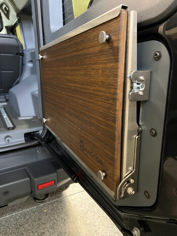

Mine was the same way. I thought over time it would fit but it didn't change over a couple months. I pulled it out one day with difficulty, wiped the oil that I was given with the table. I thought this would make the wood swell up and I would have to sand it down but instead it shrunk the wood to the point my table was sliding around now in the metal slots. I just had to make the modification with 4 thumb screws to get it tight and reduce the rattle.
Yup, mine was loose from day one and four thumbscrews is how I resolved it. What I like about the modification is when the table is down and extended you can snug up the two inboard thumbscrews and it holds the cutting board solid so it doesn't move around while you have stuff sitting on it.
Would you be willing to share information on those thumbscrews, where you sourced them, etc? Did you install a threaded insert for each of the thumbscrews?
Sure thing, here is a link to a write up I did a while ago which goes into more detail on how I did it and parts used:
Thank you very much. McMaster-Carr order inbound.
