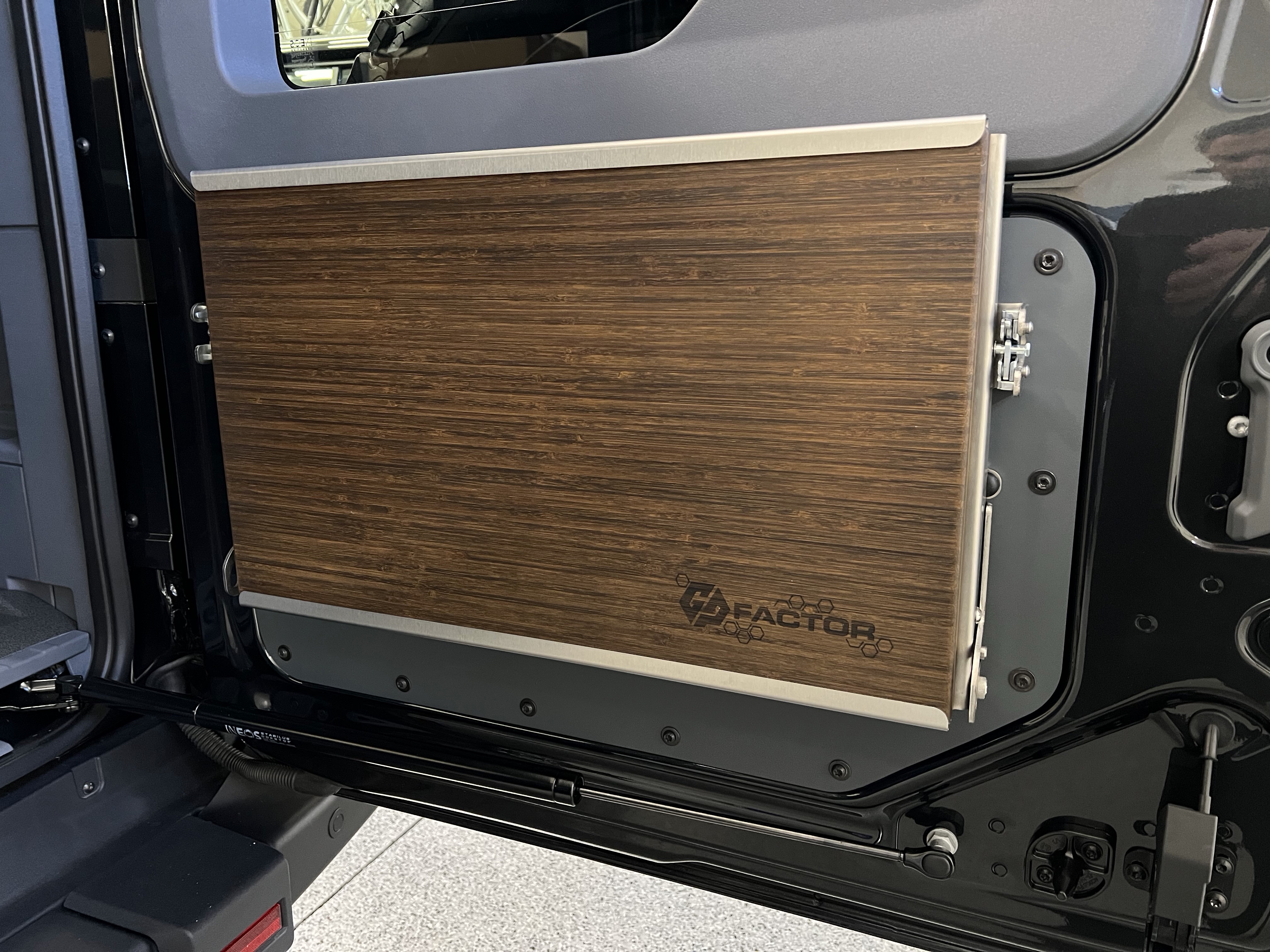

I just installed the GP Factor table and let me just say the quality of their products is incredible. The table and folding mechanism is built like a Swiss watch and installation was a breeze with no issues… gotta love a well engineered product like this. I also took some extra time and stained the cutting board for a more subdued look.
I used a pre-stain conditioner and four coats of Varathane (Ebony) stain then simply sealed it with a wax paste. I wanted to preserve the natural finish of the bamboo and didn’t really want to mess around with polyurethanes. I won’t be preparing food directly on the cutting board as I’ll use a smaller plastic cutting board on top in order to keep the shelf looking nice. Here are some pictures for those interested in how it turned out.

Was the varathane food grade? Also what wax did you use? I just got mine a couple of hours ago and am headed to Home Depot to pick some up!

Thanks for the pictures @C-Mack … looks great! 👍

The stain I used was just Varathane standard stuff. I won’t be putting food products in direct contact with the board as I use a separate smaller HDPE board for chopping, etc… I wanted to keep the GP board looking good and use it more as just a handy shelf for general prep and let the other cutting board take the abuse and keep it disinfected or throw it away once used up.
There are products from Watco (see image below) which are supposed to be food safe but what really is 100% these days as it seems like there are chemicals and risks with everything. The GP board is so nice I wanted to treat it a bit more like a piece of furniture hence the stain and wax to try and keep it hydrated as I live in a low humidity area.
Here are some pictures of the products I used and I believe you can get them at Home Depot or someplace similar. I used a combination of foam brush and lint free painters rags for application. Use a pre-conditioner first wait about 30 minutes or so then apply the stain. Once you have the stain to the color you like let it fully dry for about 24 hours then wipe it down with a clean rag and then you can apply the wax which was oddly therapeutic. Enjoy!

Thank you Sir! We will probably be using it for having food on it so I will probably go the Food Safe route. I have used Tung oil in the past and may go with that.
I was at Home Depot just now but they only had the Watco (in the food safe) and it was Ebony. We generally like the color of the board as is but a slightly deeper finish would be nice and I think the Tung oil will be ok...as well as mineral oil. I would definitely apply a wax afterwards.

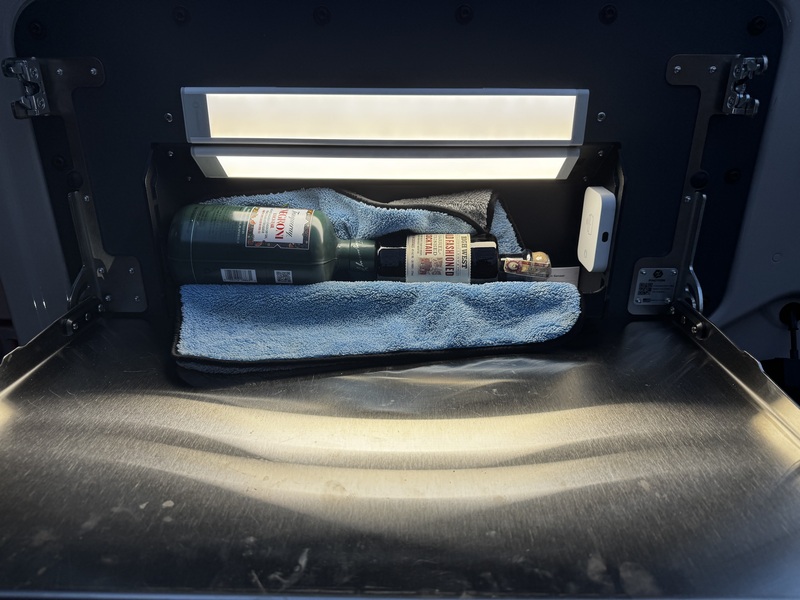

I should have posted this little modification for the GP table here for anyone following this thread.

Instead of hard wiring lights I purchased these glowright USB -C charged lights and a door sensor they work great in my drop down table so far. https://glowright.co/?utm_campaign=xsell outdoor max (SmQ43m)&utm_medium=email&utm_source=Post Purchase Flow&_kx=4sQI5e6zUpCXjoVnoRzDeLwgZ2xwf1ZorgIAZQQPrJk.RsPpBQView attachment 7881245
Thanks for sharing, I was looking for something like this as I didn’t want to get into hardwiring a light right now. I’ll check them out.
