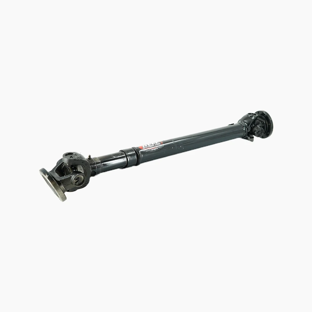

There is a solution already in the US, John Brindell knows his stuff pretty well. I believe it was installed for the Baja 1000 that he just ran too. He is really active on our INEOS Grenadier Owners - USA Facebook group if you want to check that out or reach out to him. I am still yet to see anyone running it and talk about it.

If you ask Agile about the shaft they will admit that it does not run free of vibrations at all speeds and throttle positions. If that is not important to you then it is most definitely stronger and will eliminate the issue of boot failure.

Thanks so much. Our local dealer has been replacing them when they break with the Teraflex rezepa joint and they say those have been working. However upon inspection that is essentially the exact same thing the QM comes with already. So I agree the Agile one you mention is the best route once stock breaks.
