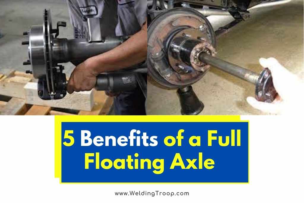

We do know that the Carraro axles in the Grenadier are semi-float, not full-float axles (like the Dana 60). That seems like a major oversight by Ineos - given (1) the weight of the Grenadier (the gas-version is 5,875 pounds, and the diesel is over 6,000 pounds - almost as heavy as a Ford F250 in its lighter trims), (2) the excellent payload of the Grenadier (almost 2,000 pounds). and (3) the goal of durability and ease of field-maintenance. See these articles for a comparison of semi-float and full-float rear axles:

Thanks for the article links - I had heard the terms but had no idea. The one really appealing thing about the full floater design is that even with a broken axle the wheel in question can still spin. It wouldn't obviously provide drive, but it wouldn't leave you stranded either.
Yeah, but the inherent strength of a full-float axle is also really important for an overland rig that is (1) heavy to begin with, (2) carrying a heavy payload, and (3) is traveling in remote locations. From the Motortrend article:
"For a full-floating system, the axle shaft only serves to transmit the rotational torque from the differential out to the wheel. It does not carry the weight of the vehicle as a semi-floater does. On a full floater, a spindle is attached to the outer end of the axle housing. The wheel hub is mounted on this spindle and rides on tapered roller bearings. It is this assembly that carries the vehicle weight. As such, a full-floating axle system is considerably stronger than an equivalently sized semi-floating system."
In practice, this means that the axle in a semi float is under strain if the vehicle is heavily loaded, whereas with a full float, all the weight is on the axle housing - not the axle.
After you bend an axle-housing in mid-winter, deep in the back-country, you get passionate about axles! 😁
