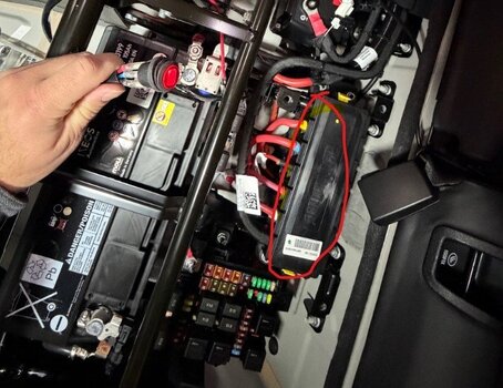

I started taking things apart and believe I can hard wire it directly into the electronics compartment. Would it be appropriate to connect the hot wire to fuse box supply (pictured)? Wondering if it’s possible to reuse one of the EXT switches for the relay…

I would take the power supply from one of the connections in the busbar that I have circled in red.
Then I would run a wire from one of the INT outputs to the relay you are going to use. Not too difficult if it is INT1 or 2, you can just tuck the wires behind the trim or under the carpet.
If you are feeling adventurous you could drop down the overhead panel and take an output directly from one of the auxiliary switches (to turn the lightbar relay on/off) and feed the wire across the headlining and down the B pillar. That would be a longer job.
For the bus bar I didn’t go in there since it’s already full, but I can piggy back off of any of the posts in there if it’s all the same.
For the switch using one of the INT aux switches will work perfectly since I don’t have a use for them anyway. Great suggestion!
