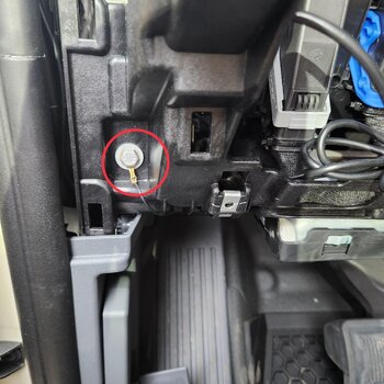

I might be making a bad assumption but a RHD fuse box is in the same location as LHD… on the left side of the vehicle, correct?
In either case, you shouldn't have to go down into the footwell for a ground. There's one by the fuse box.
Orientation from Left side of LHD truck (posted before in another thread but JIC you didn’t see it):
So close...
On RHD vehicles the cockpit fuse panel is located to the left side of the steering wheel, which itself is located to the right (and correct) side of the LHD steering wheel 🤪
