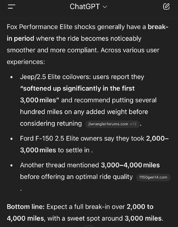

Regarding your observation - I did some research and apparently the 2.5 performance elite take 2000-4000 miles to break in. Mine are not making noise, but i also have not offroaded. They will apparently be harsh and stiff for about 3k miles. This is in stark contrast to normal shocks which only require a few hundred miles.
Personally, they are currently comfortable enough (on road) to not regret the purchase. However, i expect them to be much better after 3k miles.
