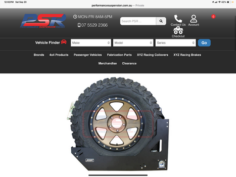

For all of you that live in Australia this might be a viable solution. Way too expensive to ship to the USA. You can mount flat against the left or right side near the cab.
