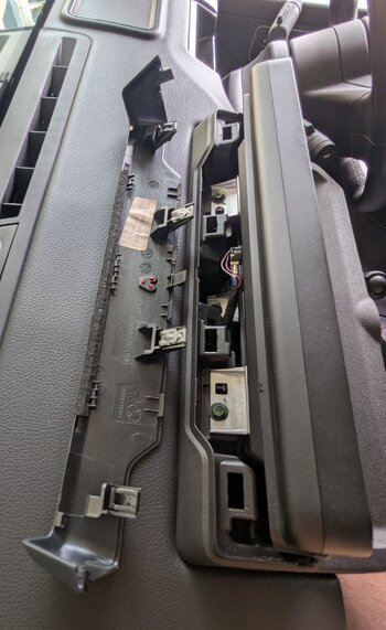

Dealer had my dash out to fix the HVAC and now I have the creaking sound. I seem a bit dense today and can’t follow the trip removal explanation. Does anyone have a link a diagram of how the trim fits?

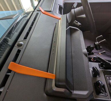

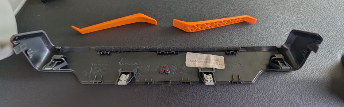

My trim has been off before so obviously it's a little easier now. I am at my vehicle now so I just popped it off again to grab these pics for you.
Try inserting some trim tools as shown. Lever the gap open a bit and the ends might release. If they don't, open up the end gaps slightly as I described above.
Most of the clips are vertical. To refit the trim align the pegs at the bottom then press down and towards the screen.

Greatly appreciate the photos. That is exactly what I’m looking for.
