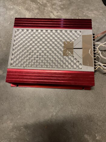

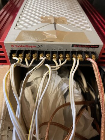

Paddy…
Should I be trying to give this another life then? (Came out of one of the first Discos I had in around 1990)
If so would it be an easy install? 🤔

I have the same amplifier on another vehicle. This amp has high level speaker input so the audio control LOC2 isn’t really necessary.
The only issue is making or finding a T harness which most likely involve a lot of repining. The harness then can be connected to either an amp or LOC2.
I did a quick cross reference for a BMW audio harness and the connectors look different.
Someone will sell them soon. Personally I don’t like splicing into original wires.
