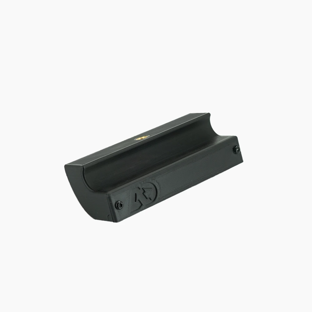

I haven’t seen any other solutions yet. If you want something similar you can go the Agile switch pros route and use their side burn covers or order a stock cover. It’s just plastic to drill out and there is a visible circle where the knockout would be. Not complicated. Another option I haven’t seen done is drill out the factory panel and use some toggle switches and run a loom of wires down to a fuse block under the pass seat. Not sure how much space is above the panel.

Here is a 3D printable file for an external cover that I found. It might be an option for you.
