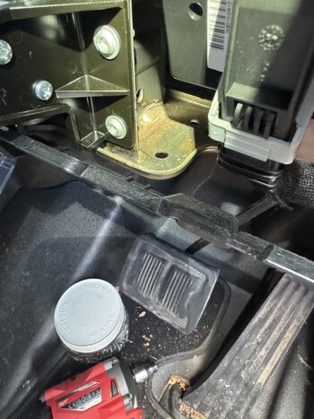

IF YOU MADE IT THIS FAR I NEED YOUR HELP:
Now this is the part where I need the help of the hive mind.
I need to get the mode wire that switches the defend light modes on the light bar to the drivers footwell (RHD) anyone has any ideas? I have the safari windows so the opening I was planning of using is in use.
Thanks guys.
