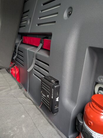

Back wall
Killer! That's a much better location. I'm assuming that you drilled into the plastic cover for the mount bracket, yes?
I have so many other questions about what you have mounted back there! That long, red in the cubby above the radio unit; is that a caution triangle? Something else?
Yes I drilled, was cautious with smalls drill bit.
Caution triangle and the other side is the rest of road side emergency kit. It came with fire extinguisher.
