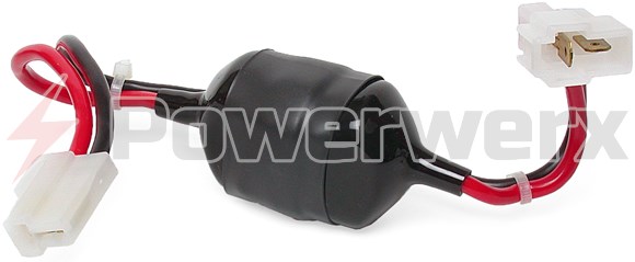

I use these noise suppressors from powerwerx.
Completely eliminated any alternator line noise, highly recommended. I have the same midland radio.
