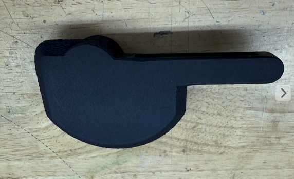

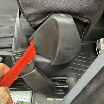

A big Thank You to Ladislav Cocher for sharing his design for a new seat back recline lever. It is so much better than the Ricardo. After printing it took 5 minutes to lift the old one off and install the new one.
Ladislaf reccomendations
  1. Printed with ASA375
  2. Minimum 5 outside perimeters
  3. 40% infill
  4. Mirror to print LHD Drivers seat. This one is for RHD
  5. I sanded the sharp edges off the handle
  6. I painted it with a matching pint to the Riccaro Grey
  7. Pry off with pry tool
  8. Tap new one on with a plastic hammer and cloth.

pretty cool. So frustrating trying to explain to passengers how to recline while we're on the move.
