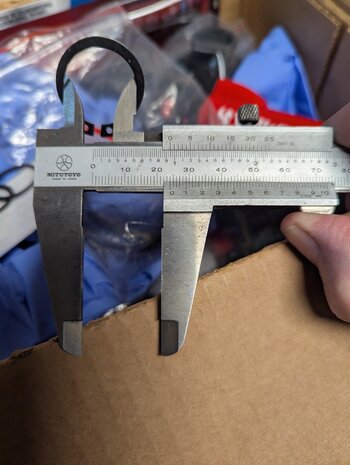

Anyone know the dimensions for the circlip on the drive shaft end?
The Crown CV kit, which is the same as the Teraflex CV kit, has a 24 X 1.2mm external circlip. I bought two more as spares. The extras are closed up a bit more so they measure 23 X 1.2mm.
I haven't seen anyone specifically say which circlip they used when they installed a replacement CV but it would make sense to use the one in the kit so until I read otherwise I'm relying on that to tell me this is the correct size.
Thanks Clark. Need a spare with the re assembly of my drive shaft.
