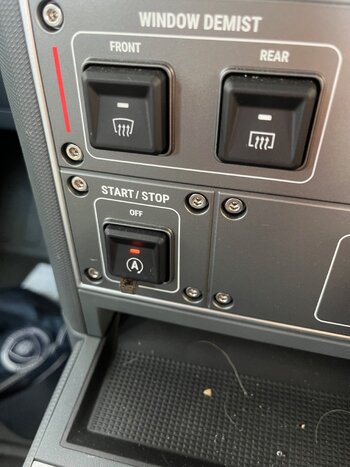

I finally solved the auto stop switch problem.
The switch OFF tool introduced on YouTube was actually too expensive to even think about, and it was currently out of stock, so it was difficult to solve.

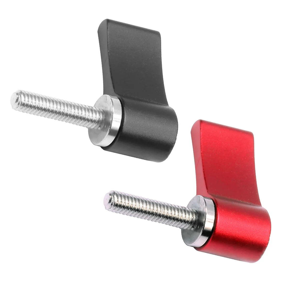

However, I found the camera fixing parts below.
The handle and bolt (M4) are assembled with a spring hidden inside the handle.
That is, when you pull the handle, the spring is compressed, and when you release your hand, it presses the target with an appropriate amount of force.
The M4 bolt is the same size as the factory bolt, but the length is shorter than the factory bolt. Therefore, it is perfectly assembled to the front panel and functions.
Assembly time: 5 minutes
Tools: M4 Allen wrench
There is no shaking when I press the upper left corner with my hand.
The camera parts were purchased from AliExpress, and they are European standard approved, so they are elaborate and sturdy.
Please refer to the purchase link below.
Enjoy with this.
Hi- thanks for the post… the link says not available in my area so I can’t see the details… Do you know the length of the screw? I saw various options/ 10mm, 17mm, 20mm… Thanks!!
