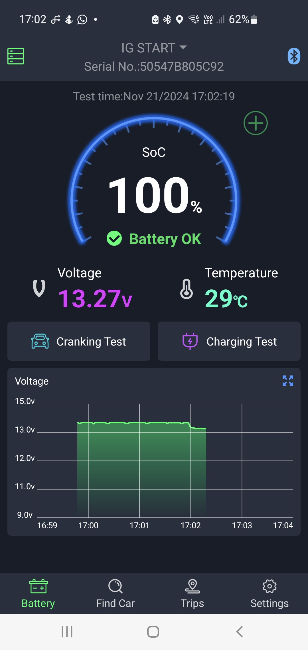

@Trialmaster yes, it´s „funny“ information. I was for 3 days on camping. Fridge runs, some electronic devices charged, battery dropped down with my two separate battery monitors measured to 34% Starter and 47% Aux. Battery. Info Display of Ineos 57%. Car start without any problems. Driven 300km motorway, go to fillingstation (14.6 l/100 km on 600km trip with Soft RTT and full loaded) Battery status at Ineos 0%, my status monitor both 100%. Car started and drive normal without any alarm, instead of red 0% for battery. Arrived home, switched of…..10 min later, status Ineos Battery monitor 82%…..It looks not like a reliable sensor.

Personally, after having one year my car, and more than 30000km AND for the first time of my life really interested in understanding my battery monitoring system (BMS), I am not too worried about the percentage SOC (State of Charge), because it is evident this is some kind of calculation.
I don't remember having had 0%, but I was sometimes quite low and the car started. Usually I am around 80%. Sometimes, when driving on normal roads in hills or mountains I saw a SOC as high as 99% (never saw 100%).
I hope the calculation method of the Ineos BMS is better than the method of my Chinese battery spies, because Ineos can take into account more parameters like temperature, current (Ampère), Voltage (of course!) ,and perhaps some more parameters, while my Chinese system is probably only based on Voltage. and battery type.
