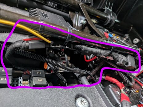

crude wiring diagram attached
heres a pic of everything as it sits in the Grenny
yellow wire is the trigger from the headlight, i made a simple piggy back loom from the back of the left hand headlight, you could probably use the Stedi Grenadier loom for this?

Is the yellow wire the same on diesel and petrol cars?
the yellow wire i added in
you need to make a piggy back for the back of the headlight
the headlights use 6 pin Deutsch plugs from memory, so make a small lead that extends this, then tap in to the high beam in this lead.
that way your not hacking into the vehicle loom
you could probably hack this up to make the lead
