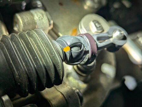

A couple of cable ties as a temporary fix to support the sockets. I can't see any cracking but I didn't tempt fate by removing them for a closer look.
Zooming in, the point of failure is just at the end of that slot. The material is very thin at that point.
Thanks @landmannnn. It's not a no. There is a white mark visible on the rim of both couplings which could be a closed crack. I'm not going to pry on them to test it out. Once I have replacements I'll be able to play some more.

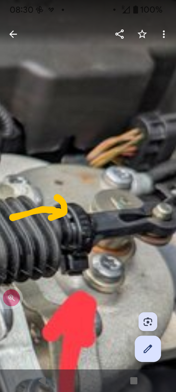

Looking back at this post, which may be one of the first reports of this fault, I can see the failure is at the same point.
So there you go B57 owners, check your EGR couplings if you haven't had the campaign done yet.

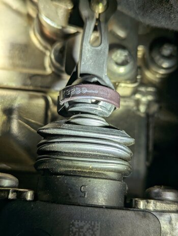

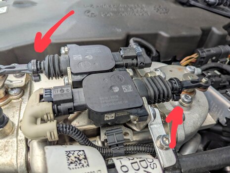

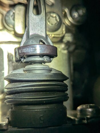

A follow up to this thread. These are the Ineos replacement parts for the EGR coupling (Actuator Pushrod).
PN GRA-3H24-013810.
The original part has a slotted cup and is susceptible to cracking hence the service campaign to replace them.
The replacement part has a full cup and a thicker rim so should be more durable 🤞
Edit: Magnified pics added. Crack in old parts visible. A good pickup by my agent's technician.
