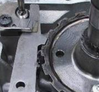

Have a look at this ZF parking pawl.
When you engage park the pawl may drop into one of the slots, or on a flat section.
If you engage park on a hill and the pawl is resting on a flat section the vehicle will roll until the pawl engages. That will eventually wear the pawl or the gear.
Note the pawl on the ZF HP8 is controlled by a solenoid using hydraulics, actually the solenoid disengages the pawl rather than engages it.
