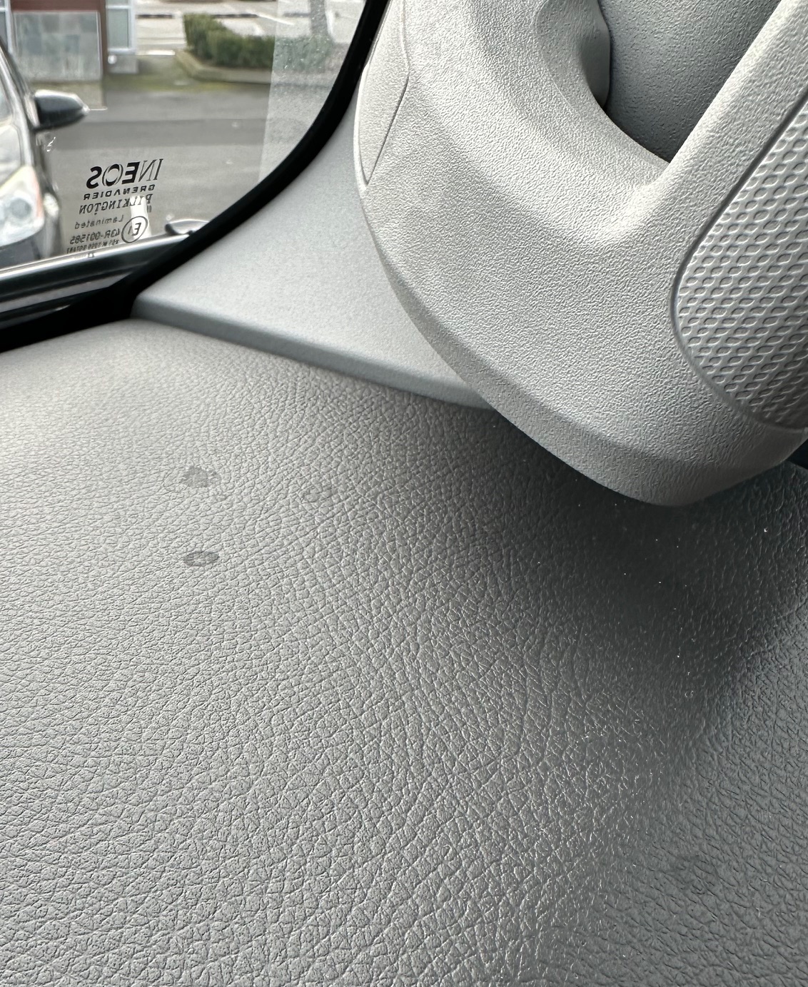

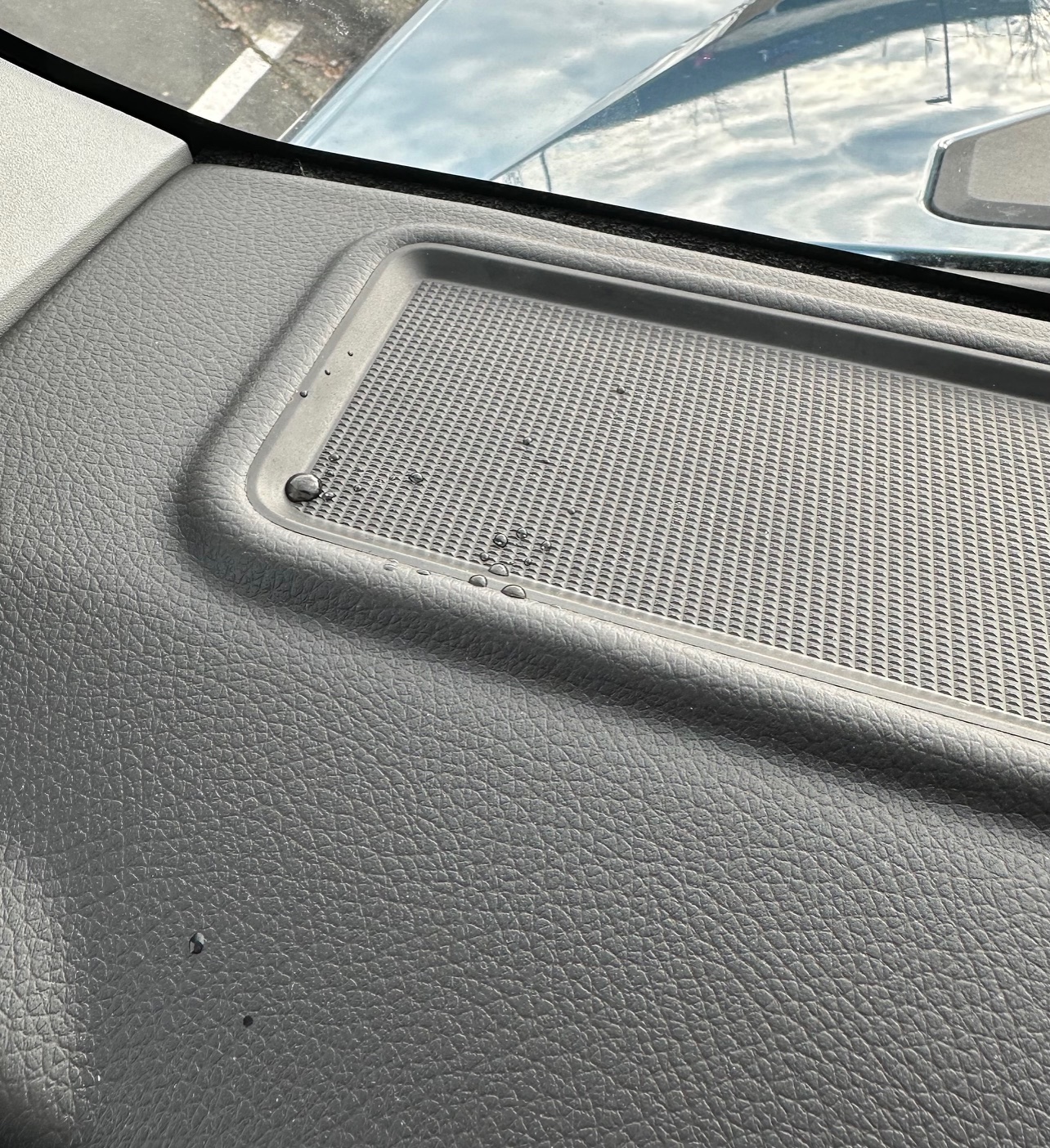

Has anyone had their safari window seals replaced at Elliott Bay? My seals are leaking.

Yes, I have spoken with Bailey a couple of times and he has offered to help. I am very happy with their response.
I have postponed help hoping to get tow hitch and transfer case shifter assembly done at the same time. Turns out my windshield seal is at least part of the problem. I will call again Monday and schedule.

I picked up my Grenadier yesterday and there are some positives and at least one negative.
Elliott Bay was great. There were a few issues to deal with and they offered a rental. I have another vehicle so I asked if they could give me a ride (2 plus hours) instead and they did.
I now have a trailer hitch - awesome. They installed a the tcase shifter pin assembly and it seems to shift into low easier than before. They resealed my safari seals. They reattached the molding above the windshield. They said the molding was not a seal and was only there to direct water. Supposed to rain again starting today. It will be easy to see if the water leak is actually fixed.
They said they found my tcase leak and fixed it. They did not, same 2-3 drops of gear oil on the garage floor this morning. So happy and frustrated at the same time. They will be getting a call from me this morning when they open. They already diagnosed it incorrectly even after I offered pictures and information from others that appeared to have the exact leak. Sh!t

Hopefully they get the t-case leak solved. I’m curious if they tested the new safari seals with a garden hose or was it the “hope and pray” method?

Thanks, they said they used a hose and sprayed the safari windows for an extended amount of time. I go back on the 28th and will drive in the rain every chance I get between now and then. I still love the vehicle!
