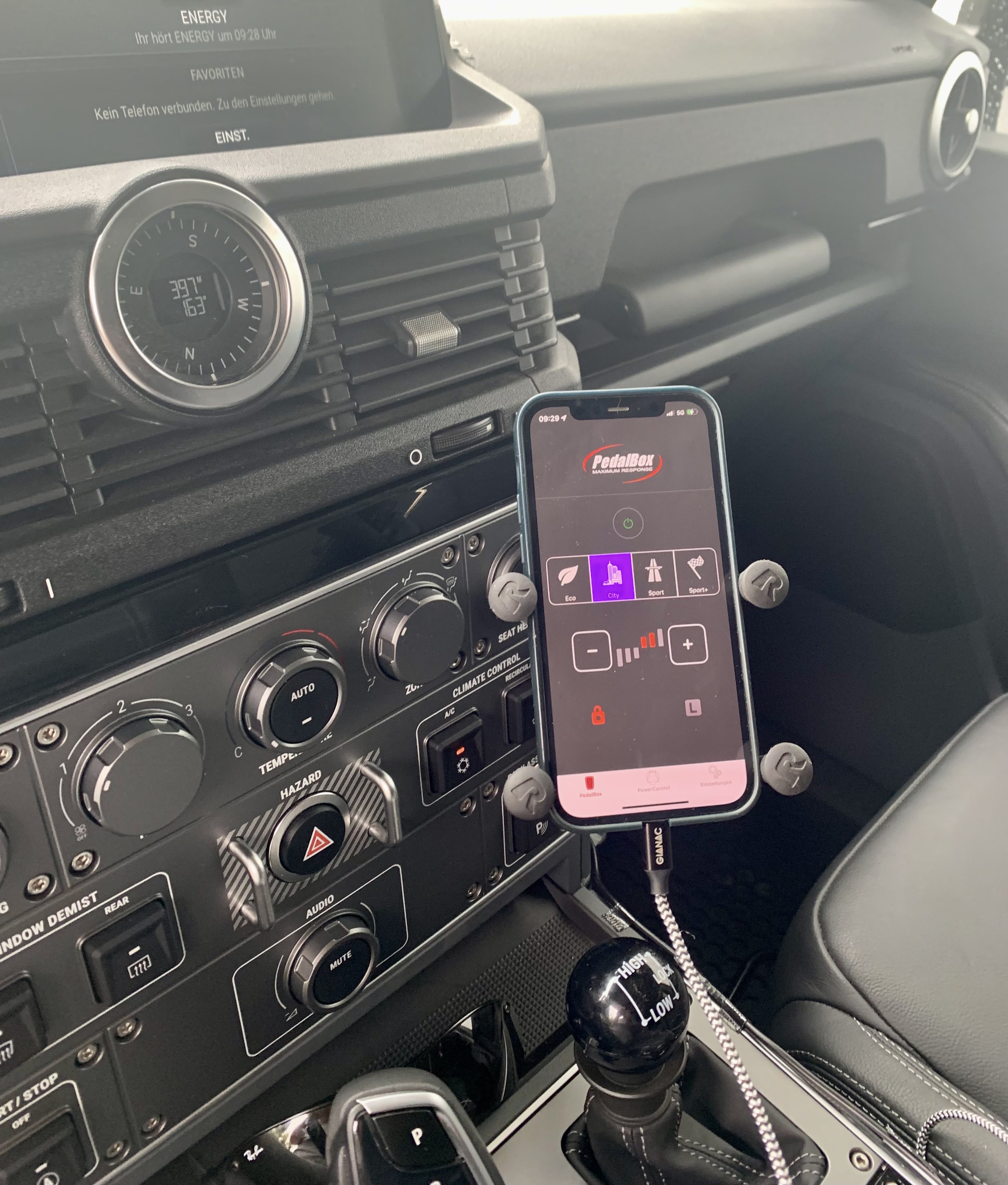

Got the Pedal Box Pro installed and more than happy. Delay reduced to a min., low-modus perfect for technical sections or hooking up a trailer, additional security w/ locking ability.
