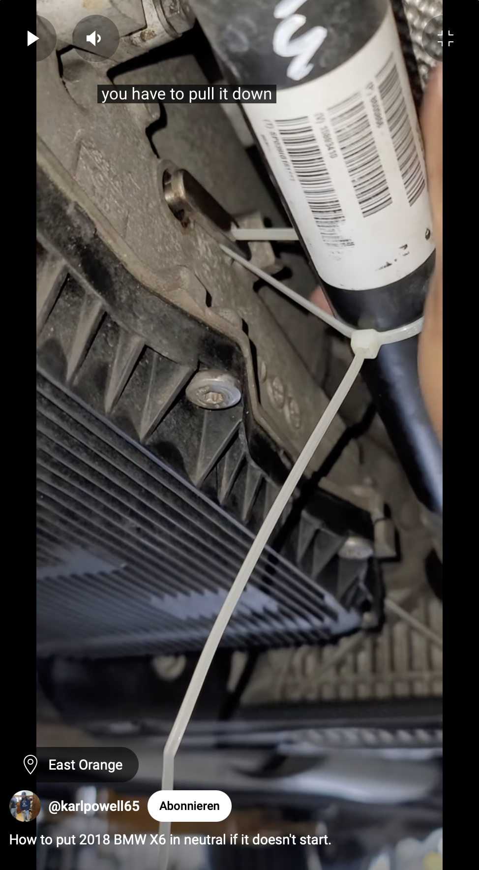

I've started a DM chat with @Rok_Dr about adding a new topic to his guide about moving a disabled vehicle for recovery via flatbed.
The only Ineos documented method is the transfer case bolt which requires access underneath the vehicle which was not an option in @Jeremy996's situation. At least one NA owner has previously reported that method didn't work and he had to remove the rear prop shaft to get his vehicle onto a flatbed.
For other ZF-equipped vehicles there are a few options to get the transmission into neutral including:
1. The lever on the left side of the transmission main case (not the transfer case). Early ZF had a lever and stop bolt that was wound in to hold the lever UP. Later ZF incl. all IA vehicles have a lever that must be pulled DOWN. It's unclear if it must then be held down to keep the parking pawl disengaged. Probably, yes.
2. On earlier BMWs (c.2008) there was a latch under the shifter cover that could be toggled to force the transmission into neutral.
3. If battery power is available, late BMWs with a start/stop button can be placed into neutral using a simple sequence. IA opted to supply a keyed ignition so that option is a no-go.
We can place the transmission into neutral while the engine is running but it reverts to Park when the engine is turned off. The workaround is to use Carwash mode provided the engine can be started and left running, or at least the key left ON with battery power while the vehicle is moved. This keeps the transmission in neutral so it can be rolled or towed onto a flatbed (but not flat towed along the road). Of course getting into Carwash mode needs an operable engine with battery power.
The small lever on the left side of the ZF transmission must be pulled down and locked there. There is even a special tool from BMW for this. See pictures
That’s the older version of the box. The current version doesn't have that feature.
