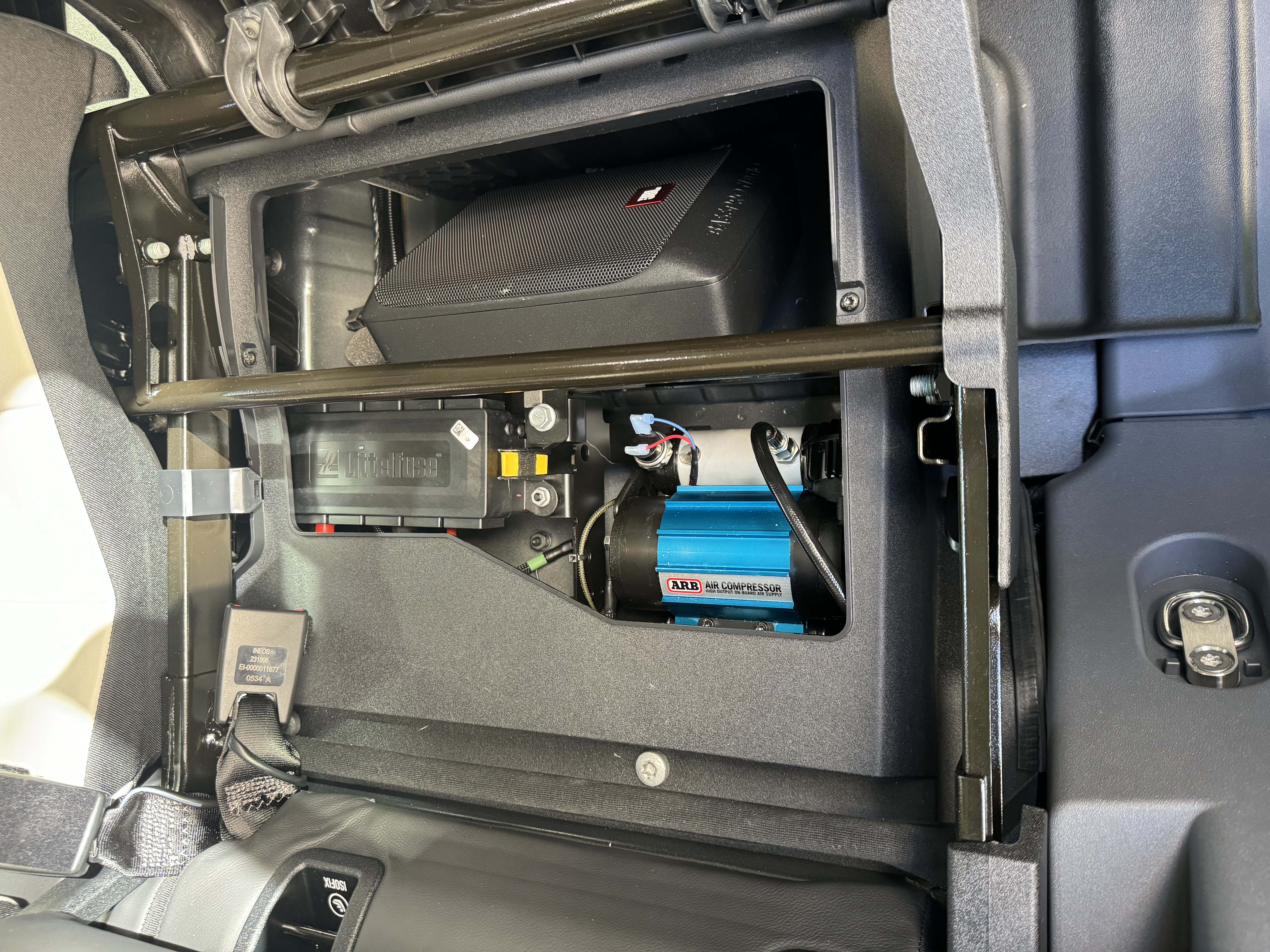

Trying to figure out the best place to put this, and this thread looked like the right spot before all the Owl talk! I’m new here so LMK if it should go somewhere else.
I installed the Agile one today <pats himself on the back>. I’m mechanically inclined but this is definitely the most invasive thing I’ve ever done to a brand new car (delivered last week)! But the kit was amazing - everything was just right and the instructions were perfect. I hadn’t seen the OPs video, which would have been great also…. So thanks Agile for a nice kit that a rookie could handle installing.

So, I installed the compressor under the seat yesterday. After having disconnected the positive lug on the battery, I now have warnings that the front and rear differentials are on and the AEB is off. Any suggestions?

Not really, but some warnings disappear after some hours driving. For instance I had an "orange warning" on tire pressure some days ago. I used - of course - my compressor to put some air in the tire, and only the next day the warning was gone!

Did you wait 15 minutes or so after taking key out of ignition before disconnecting the battery to attach the power supply for the compressor? I fitted my ARB under seat compressor a few weeks back and no problems apart from a few warning lights on after initial start up. These soon disappear after a few minutes driving. The only light that stays on after battery disconnect I find is the passenger airbag is turned off and a warning light is on for that. The procedure for turning the passenger airbag on and off is in the owners manual.

Yeah, per the recommendation of an Ineos sales guy, I drove the truck for a bit and the errors went away.🙄

The key had not been in the ignition for hours. After driving for a bit, errors disappeared.
Did you connect the positive to the main battery or to the secondary battery if equipped with one? I’m currently connected to the main battery but, my brother said I should connect it to the secondary battery instead. Thoughts?

I just disconnected the -ve on the main battery.
