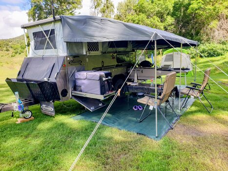

I have the CFF70DZ in my Lifestyle hybrid camper. The CFF series doesn’t have the Bluetooth remote monitoring feature that the more popular CFX series has. Other than that I believe they’re much the same in function and performance. I have been using this one in dual mode for 5 years. The only niggle I had was a cutout issue which took me a little while to figure out was the low battery protection system. Once I reset the cutoff level it was sorted.
This one lives a sheltered life on a pullout slide on my camper but at times it’s got wet, dusty, and operated in full sun in hot weather (36c/97f). It’s been solid. I’d buy again.
