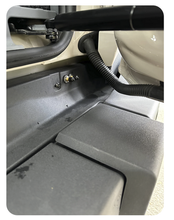

Also where do you guys place the air nipples?

1. Most airbag kits just use the standard tire valve and you use a standard tire inflator. Your onboard should be fine.
2. Most air nipples are placed around around the rear bumper, either in or under the bumper.*
3. You do not need an integrated air compressor, any air hose can inflate them. Airbag kits with integrated air are always way more expensive.
4. Match your air bags with any lift you have.
*GrenX places them here (safe, protected and away from pranksters):
img_4077-jpeg.7865410
This is where inflaters are, I have the Polyair bags.
