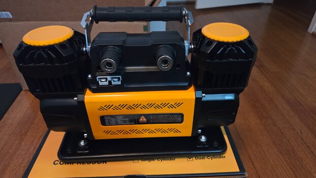

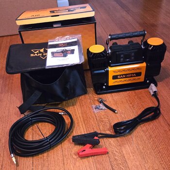

I got a new San Hima 12.36cfm dual compressor air compressor to make myself a 4-tire at once inflation system for my Grenny. I’m going to make a new cable to connect the compressor to the NATO 2-pin plug. That’ll save me from having to raise my hood to connect to the battery because invariably kind heated folks stop (as most good outdoor folks do) to check on me with my hood up. That and I’ve been looking for a chance to use my NATO plug. NATO adapters still in the mail but I did get the compressor and now I have a question on wire size and plug type.
Compressor’s Anderson plug is stamped SL80 NOT SB like all the other Anderson plugs I’m finding on the internet. Terminal inside is still labeled 6 like a true terminal.
Question – has anyone ever seen a SL80 plug before? And is my assumption that the 6 is for 6ga so that’s what I should use for me new extension?

It is an "Anderson style" plug (not a geniune Anderson plug) as you note, so they tend to do whatever they want. It can vary between each brand.
It looks like a standard size 50amp Anderson plug, but the wording denotes a 80 amps rating (the Anderson at this size is only rated at 50 amps) and often fused at 40 amps.
LUG SIZE-INTERNAL DIAMETER
The lug sizing (here stamped as 6) on the lug normally denotes the internal diameter of the of lug and what wire gauge it takes, but those standards apply to genuine Anderson plugs. You can buy genuine Anderson lugs in 3 internal sizes, 6AWG, 8AWG or 10-12AWG. There are 3 internal diameter sizes for genuine Anderson lugs, not one. The external size is the same on all 3. Size 6AWG is the most common.
CABLE SIZE
The cable size needed is determined by the current draw and cable length. From the Resources links:
