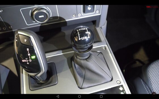

I see the buttons for the front and rear diff lock, but the center? Is the high/low lever actually not just 2 position, but 4 position- Hi/center lock, low/center lock, just low, just high?
See here:
In the video linked below the designated driver explains it after 38 minutes (in English).
Does it help?
Thanks. So you can have it in low or high, with the center diff locked or open- and that is all controlled by a single lever.
Also, to switch from low/high, you need to be about 8km/hr. But to engage/dis-engage the center diff, that seems like it can be sone at any speed. That is what I took from the video.
Just like an old Defender its always in four wheel drive which is good one les thing to think about is it in sand is it in snow is it in mud ruts ? which one is best in a Grenadier you just drive and switch diflocks as needed simple you can can concentrate on the driving.
