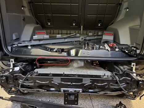

Interestingly, on my particular vehicle shortly after taking delivery, I had noticed a dull thud noise from under the cargo area flooring when going over bumps. I traced it back to the three bolts which hold the charcoal canister (red circle in attached image) in place which were only finger tight. This allowed the canister to bounce up and down in its mount which was making the thud as the canister has some mass to it. I snugged them up and the the thumping disappeared. I guess those weren’t properly tightened during production?
Kind of pain to track it down but sometimes a simple visual inspection is all it takes to find a strange noise.
