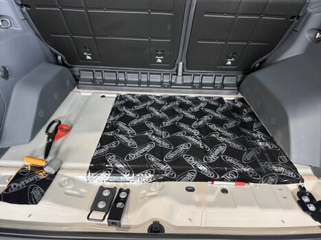

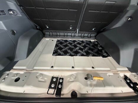

If the Dynamat in the trunk becomes an issue, I’d rather just install a drawer system to mask it…
Yes, on steel wheels if it matters. I'll do a sound test with the same when I get the truck back, but after that they're going to be replaced.
When i sound deadened mine, there was definitely a reduction in overall noise levels and i was even able to reduce wind noise by adding sound absorbing material in the a-pillars. The boom may have slightly reduced but it is still there. I am interested in hearing your results
