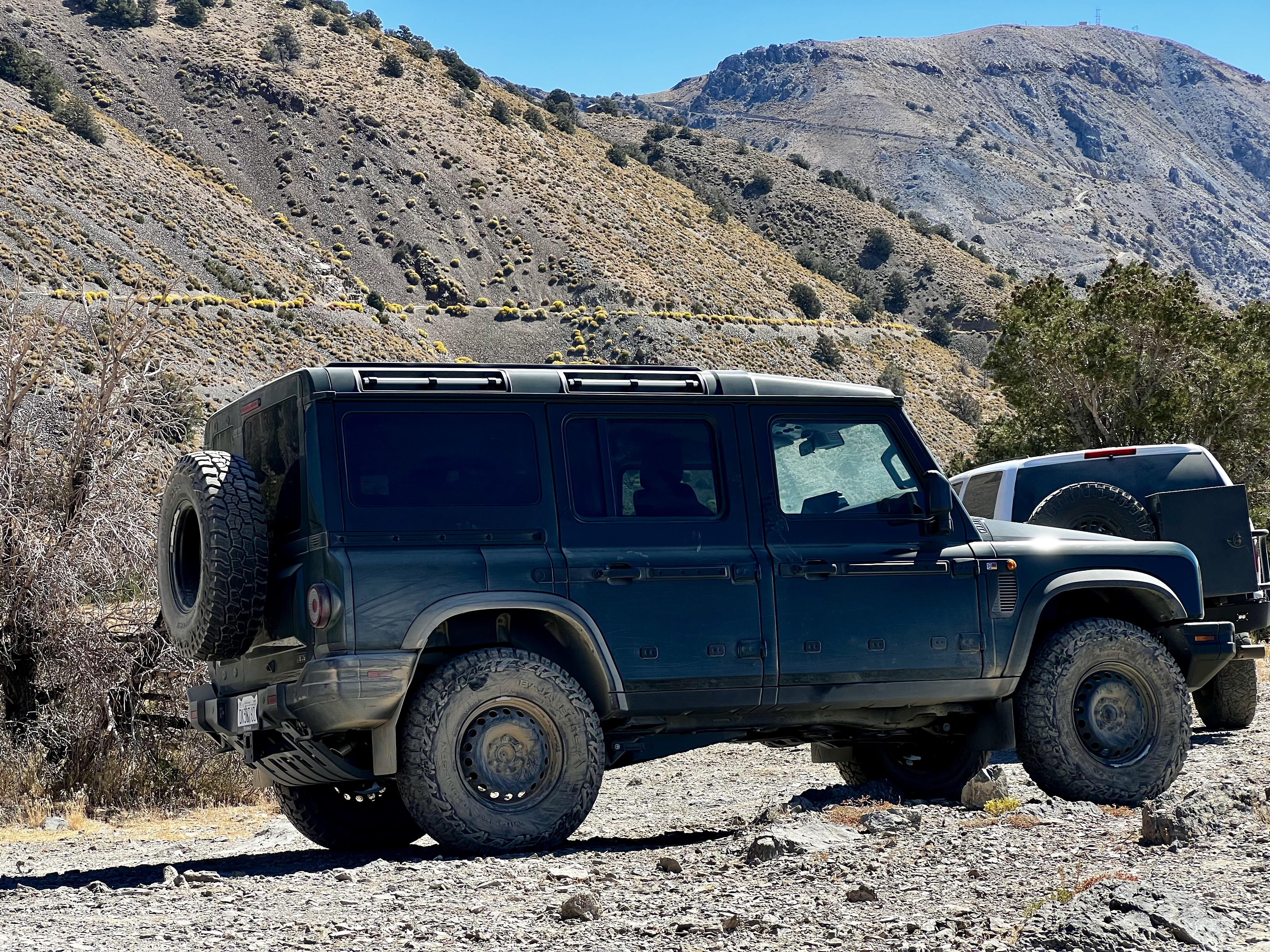

Hello Eveyrone,
If I want to increase the tire size but keep the factory 17" steel wheels, what is the maximum tire size that I can go to?
Kindly advise. Thank you. Mark
So the stock tire is a LT265/70 R17 which puts it at 31.61" overall diameter and a width of 10.43"
If I go to a 285/70 R17 that would put the overall diameter at 32.71" and a width of 11.22"
If I go to a 285/75 R17 that would put the overall diameter at 33.83" and a width of 11.22"
For you wheels & tire guys out there, would both size upgrades fit without rubbing or the need for any suspension modifications?
Thanks for the forum help, nice to have a place to ask. Mark

Both of those options fit without any lift
The tallest I've see claimed by Dirtbox Overland (look them up on youtube) is a kenda 35x10.5. next was a MT 255/85r17. Cant vouch, I havn't seen 'em in person.

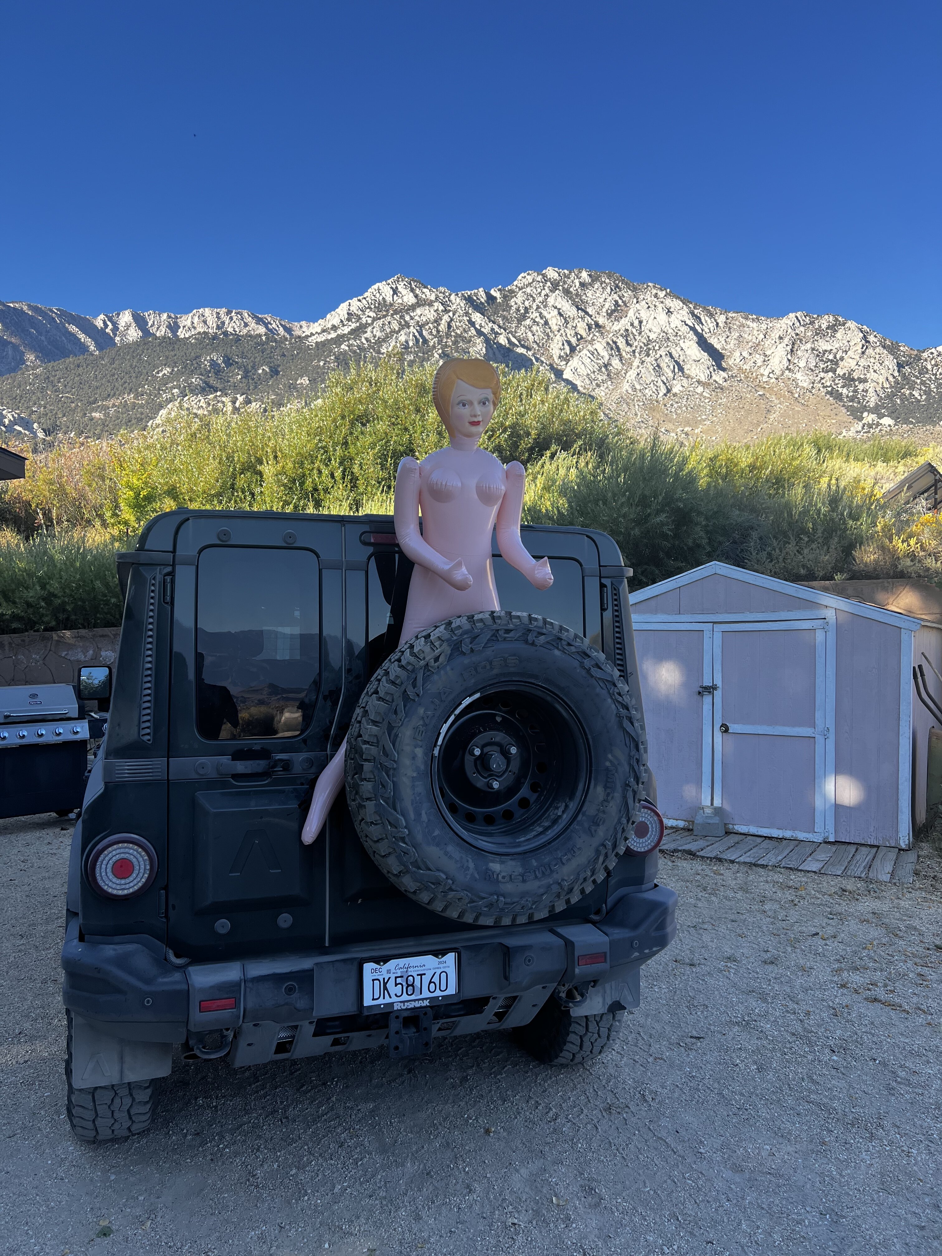

Thanks for the recommendation. Would it be possible for you to please post a picture of what your spare looks like from behind the vehicle as mounted on the Leitner relocation bracket? I just want to make sure it doesn’t completely dominate the back end of the vehicle aesthetically wise. In addition, I have the 17 inch alloy wheels, would that make any difference as compared to the steelies ? Thank you very much.
Thanks for the recommendation. Would it be possible for you to please post a picture of what your spare looks like from behind the vehicle as mounted on the Leitner relocation bracket? I just want to make sure it doesn’t completely dominate the back end of the vehicle aesthetically wise. Thank you very much.
You can see that the tire is moved to the right and up. Lot’s of door clearance now and the reverse camera is blocked by the spare tire as much.

I run the 255/85 MT Baja Boss on my Grenadier on the stock steelies and do not use the Leitner bracket. I simply installed 3/8" worth of spacers under the top left stud holding the wheel to the OEM tire carrier and 3/16" of spacers under the lower stud. This allows the tire to easily clear the smaller door when opened. Yes the rear camera is blocked more by the larger tire but it is still usable.
