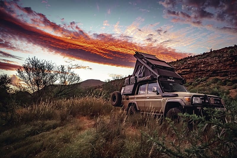

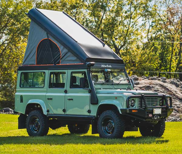

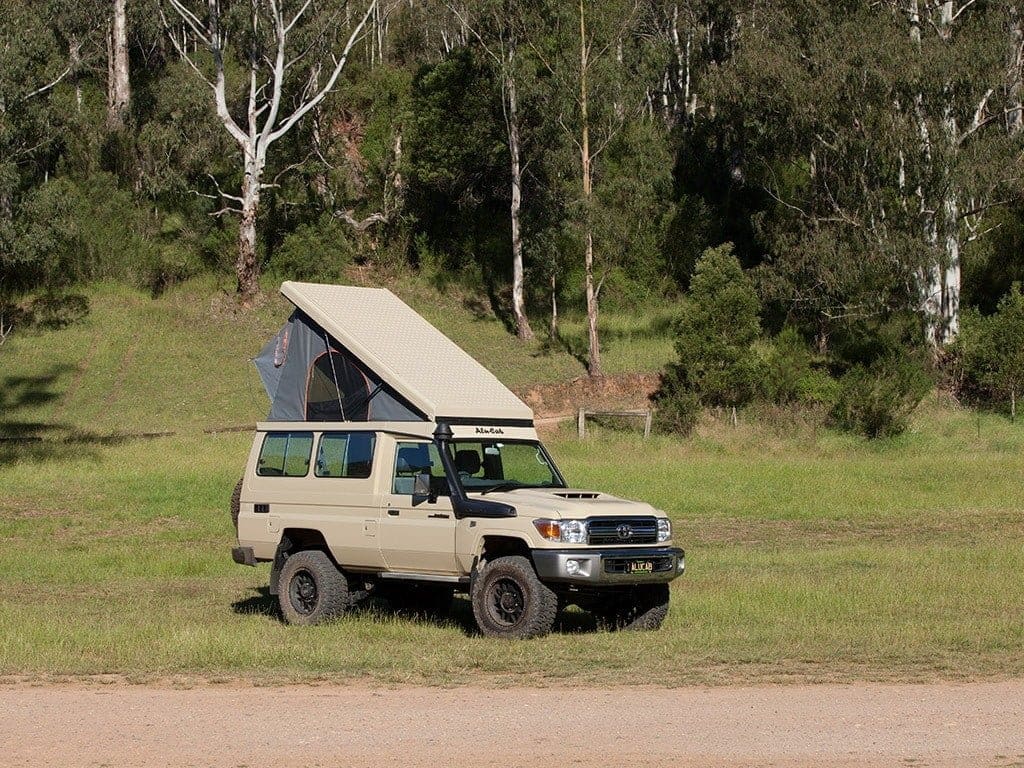

Not fit for whose purpose?
You're aware of the very well-respected LC/Troopy/Rover aftermarket, yes?
Of course any aftermarket upgrade, at least in the USA, falls under the Magnuson Moss Warranty Act. Unsure of regulations in non-USA countries.

Great product for the Troopy/Defender... BUT: the LC/Troopy and Classic Defender are structurally very different from the Grenadier in terms how their respective roof "assembly" contributes to the rigidity of the body structure overall . The Alucab approach to fitting its product to the Troopy/Defender (i.e. literally get the angle grinder and cut the top off the "sardine can") is not "fit for purpose" when applied to the Grenadier because of how the roof skeletal frame structure of the Grenadier is integral to the torsional rigidity of the body as a whole and contributes significantly to its 490kg static roof loading limit. My observation FWIW is that any Alu-Cab modification will require many many hrs of engineering rework to provide an equivalent structural integrity model which will allow them to get a certificate of compliance equivalent to that pertaining to the original ...or not!....... lots of "food for thought"!

Great points. I would argue that there cannot possibly be equivalent structural integrity with Alucab on any vehicle today. That said, It might just be much harder to do come close to what Grenadier has
