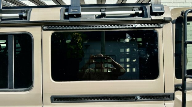

Do you mean like this? I installed 1,5 years ago - so 60.000 km . Both sides.
On one side I installed a water tank (25kg) , the other side a box (also um to 25 kg). I used Sika us primer an NO rivets.
If you need more Info, let me know.

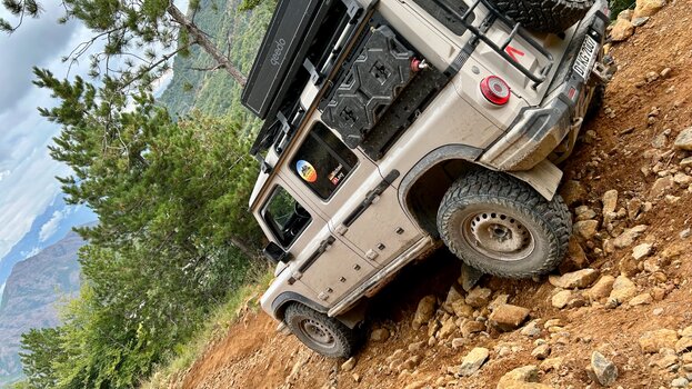

Ja genau so! Tell us more about the process of glueing it. Is it complicated? I am carrying 2x20l fuel tanks. Not for very long but sometimes on demanding terrain like corrugations. Will it hold?

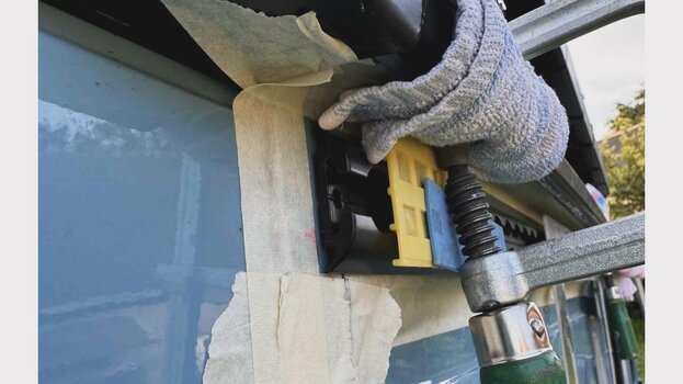

The adhesive needs a certain thickness. I used 3 little metal pins in the right thickness to keep the distance between the raul and the car and pulled them out, before the adhesive is totally cured.

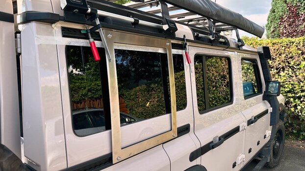

What helps to fix the rail until the adhesive is cured, is a little support-frame. See picture below.
