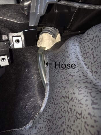

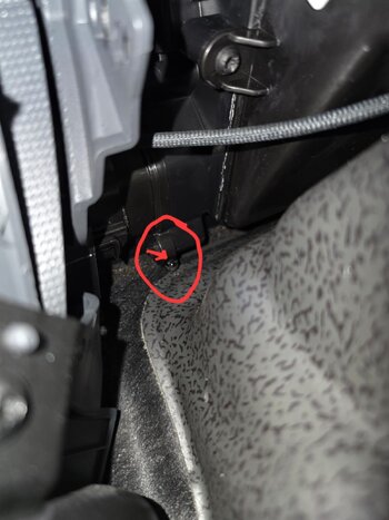

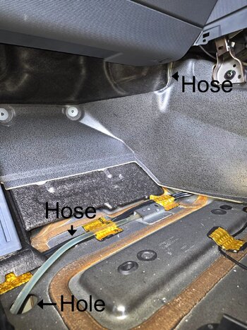

I have the water dripping problem in the front passenger side (right hand drive) as shown in the picture attached.
Using small hose I run the water to the hole on the floor.
Stupid solution but it's working.
