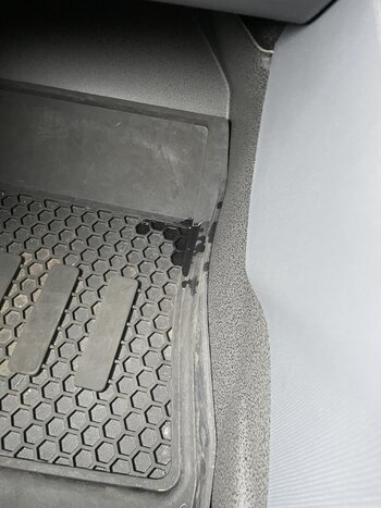

There are different types of leaks identified. If the leak runs droplets of water on the side of the CENTRE tunnel under the passenger glovebox (UK spec). You can see the droplet running down. This is the fix for the condensation leak. I’m not sure if we are talking about the same leak.

I’ve just read that TSB and it says leak down the tunnel and leaks in the footwell. Mine only leaked droplets down the centre tunnel onto the mats.
Have you had the air con on and got underneath to identify where the leaks are actually coming from. Like I said, there seems to be more than one types of leaks.
Footwell is where the droplets would go if the mat is not in place (here in the US at least the mats are optional. I know when I don't have the OEM rubber mat in place it will drip down and go under the removable floor section)
Mine happens only with the aircon on and is from condensation
Ok, with process of elimination and the sake of ripping out the whole dashboard. Have you tried doing what I recommended first. I did this myself by just topping up the coolant on both reservoirs and I don’t have anymore condensation dripping even in hot weather when the air con is on.
You be surprised how much coolant it needs topping up. Lift up the bonnet into service mode and have a look. If it doesn’t work then the dealer can follow the TSB.
