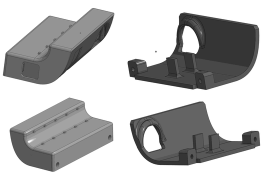

I present to you my replacement cover for the factory roof power outlets on the INEOS Grenadier.
The factory ones are fine with thin wires, but if you have thick wires you have to make them bend 90° to make them exit from underneath the cover. Even then, the rigidity of your wires can make the cover pop up, which is not ideal. With this version, the wires can get out of the casing while remaining straight, preventing unnecessary wear.
Hardware needed:
  • 2x M4 threaded inserts.
  • 2x M4 8mm machine screws,
  • Optional but recommended: Mounting tape.
I printed it with Carbon Fiber reinforced Nylon to resist the elements, but ASA would work well too.
I know Agile Offroad make a similar one but this one is mine and I'm not paying US $100 for a piece of plastic.
STL files are available on Thingiverse.
If you want to make modifications, log in to Onshape, and create a copy of it: Edit in Onshape
