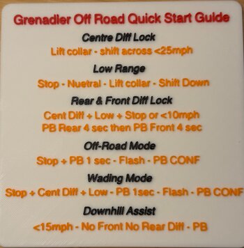

A simplified 3D print version of Rok Dr's Guide "Off Road Function Quick Start Guide" to be placed in the G for quick reference. A STL file and 3MF file included in the zip file.

I have two with the "nuetral" typo. Any one local to NOVA is welcome to have them, otherwise it will go into the scrap pile. Just DM me.

Neat!
But to give credit where it’s due I just reproduced @Michael H.’s table, with his permission, in the guide.
Another thought. If it were possible it would be great if it could be made as a plaque that could be attached to a vertical surface in the car in the drivers line of sight, much like those in various land rovers and 40 series land cruisers. That said I struggle to think of a suitable position in the grenadier.

Back of the driver's sun visor?

I was making a handwritten copy in case my family was driving it.
-I don’t see in the MY24 manual the limitation of 25MPH for the center to switch from high-open to high-locked?
Seems like a good idea anyways.

It’s not in the INEOS manual. It’s referenced in Rok_Dr’s Exceedingly Unofficial Owner Manual Supplement.
